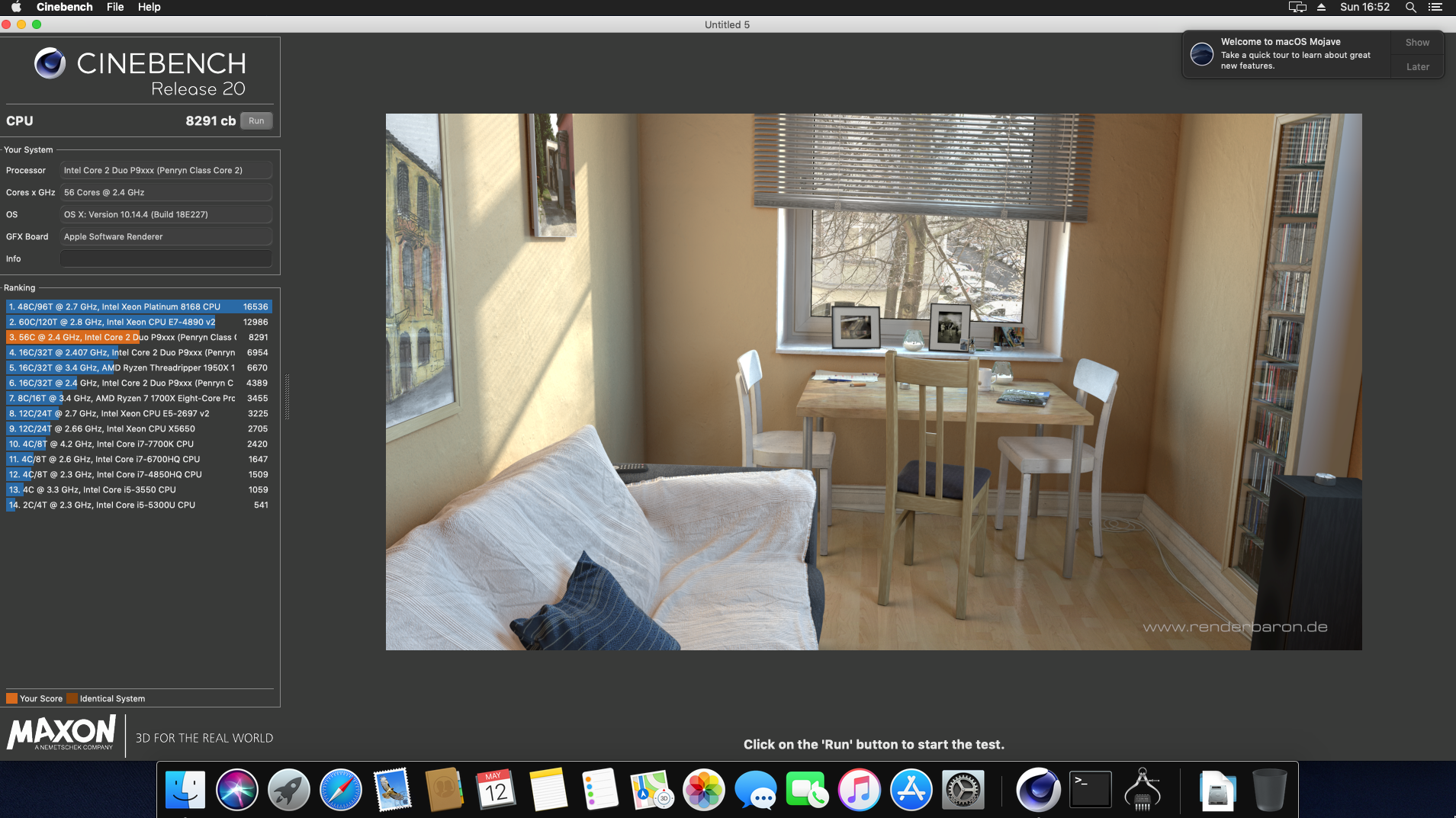

How I can Pass through more than 16 cores OSX-VM?
I have successfully installed Mojave 10.14.6 as VM with Unraid 6.7.2, and successfully passthrough my Vega FE GPU the tricky part that I have dual E5-2690 v4 CPUs with a total of 28 core and 56 Threads.
l already tried with selecting all the threads available but clover bootloader won’t boot I had the same experienced before when I used virtmanger but I used this custom flag and I was able to boot normally:
-smp 56,cores=8 \
?How I can use this custom flag with Unraid xml confg file and excluding two threads for unraid system
remove your topology from the xml, then you can go up to 64
The problem is not related to the core count as in windows or Linux vm l can easily select the cores l want and passthrough them normally via Unraid web-GUI.
macOS refuses to boot on my machine because if I pass certain numbers of cores through to it.
I don’t know if Unraid configuration format doesn’t natively support setting a thread count?
Before as @FoxletFox suggested to me with his macOS-Simple-KVM project due to platform assumptions in XNU, it's better to pass all threads as either single CPUs (_-smp 56,cores=1_) or as dual core pairs (_-smp 56,cores=2_).
But l can’t figure out how to do that in Unraid xml config.
Ok, don’t listen to me. Seeing how I’ve run OS X on an 80 core 4 processor machine at the max 64 allowed....
 The problem is OS X only recognizes certain topologies and won’t boot if its not within those parameters. Soo... yes, it’s a topology issue. Remove topology and you can do 3, 33, whatever. The added bonus is OS X will utilize threads as single cores for greater performance.
For further reading see
or, you know, don’t.
Thank you for the clarification, to be honest I kinda noob when it comes to kvm l was using macOS as primarily bare metal hackintosh.
if you don’t mind can you share with me your current macOS xml file and your clover EFI folder or .config file so l can try and replicate your setup and to achieve the same performance as you :)
Edited by Idris Gsmalla
Remove the line with this stuff in it. Just delete it from the xml.
<topology sockets='1' cores='2' threads='2'/>
I have the same experiences and was never able to solve it. Followed this kind gentlemens advice and even copied his xml but did not work. Its some magical combination of factors that makes it not work/work. Same for sierra/high sierra/mohave. Tried different clovers etc.
Topologies, no topologies , tried for weeks.
Max i got was it booted but then almost every program you run crashes.
Gave up so if you find it let me know. Run all my osx vms with max 32 vcores (16 hyperthreaded) and called it a day.
