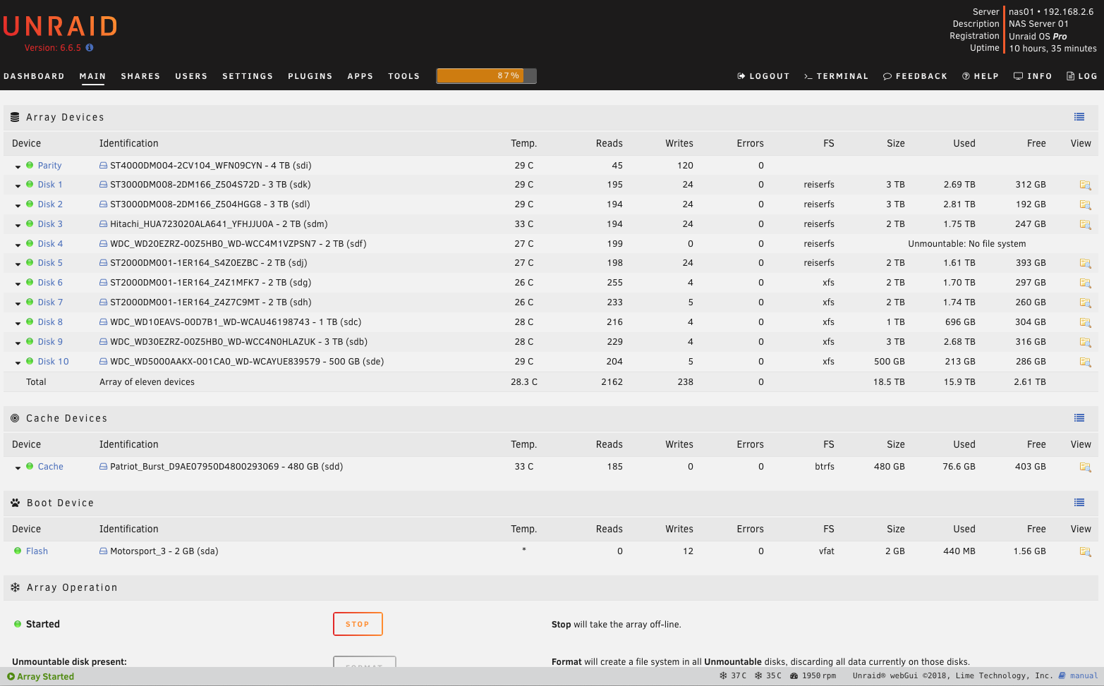

After attempting recovery after a drive / controller (PSU?) failure (see link below) I fired up Unraid and let it rebuild parity (disk 4 was marked bad). Now that the parity rebuild is complete it is still saying disk 4 is "Unmountable: No file system" (screenshot below). I assumed the parity rebuild would have taken care of this. Thoughts?

Where do I change the FS to auto?
I am positive it was reiser. Am I better flipping to auto or rebuilding the superblock?
Try auto first since no harm done, with the array stopped click on that disk, then change fs to auto.
Switched to auto - still saying unmountable. Switch back to reiser and rebuild superblock?
What about formatting and rebuilding (again) from parity? I guess parity has a corrupt FS for this disk ...
