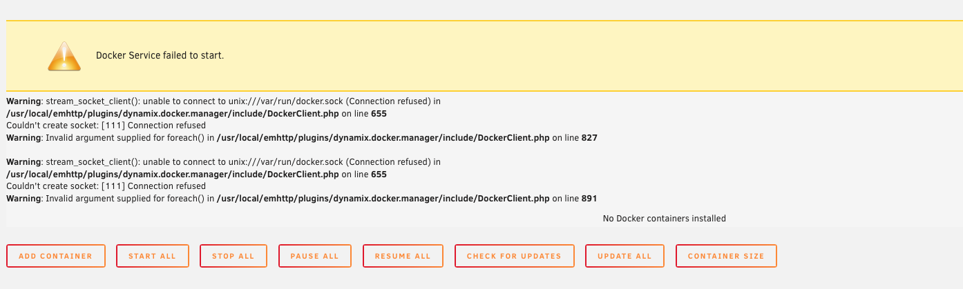

My docker service has failed twice in the last 12hrs. The first time I restarted, got into a bad boot state, replaced bzroot and everything was fine. Now the docker error on screen is back and I would like to solve the problem. I've attached my diagnostics file for further assistance. 1752814163_ScreenShot2019-08-31at11_23_20AM.thumb.png.2c7f1912655290addb007883e6e9045d.png

Your docker image is corrupt. You will have to delete and recreate it (Settings - Docker), then reinstall your dockers using the Previous Apps feature on the Apps page.
The fact you have allocated 35G to docker image makes me suspect you have been filling it. It is extremely unlikely you would need even 20G, and 20G is what I usually recommend. Making it larger won't fix anything, it will just make it take longer to fill. If your docker image is growing you have one or more of your docker applications misconfigured.
