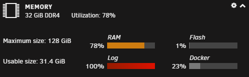

[SOLVED] Unraid logs filling to 100%
Posting diag logs per recommendation from the "Fix Common Problems" plugin. - Logs typically do not fill up immediately after reboot, but will do so after a day or two of runtime.

Ok. Made the cron adjustments and deleted the IPv6 static gateway yesterday, but still wound up hitting 100% on the logs a little under 24hrs later. Therefore, I went ahead and switched the IPv6 config to auto (DHCP), as recommend.
Edited by MarkRMonaco
Not sure what the normal growth rate is for the logs, but its currently at 15% three hours later.

I think we finally got all of the issues resolved. - About 31hrs after my last reboot, and the logs are only at 1%.
