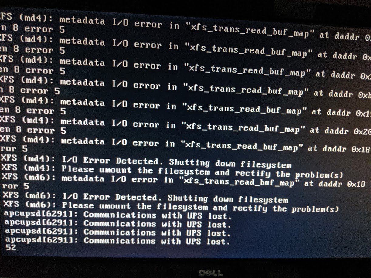

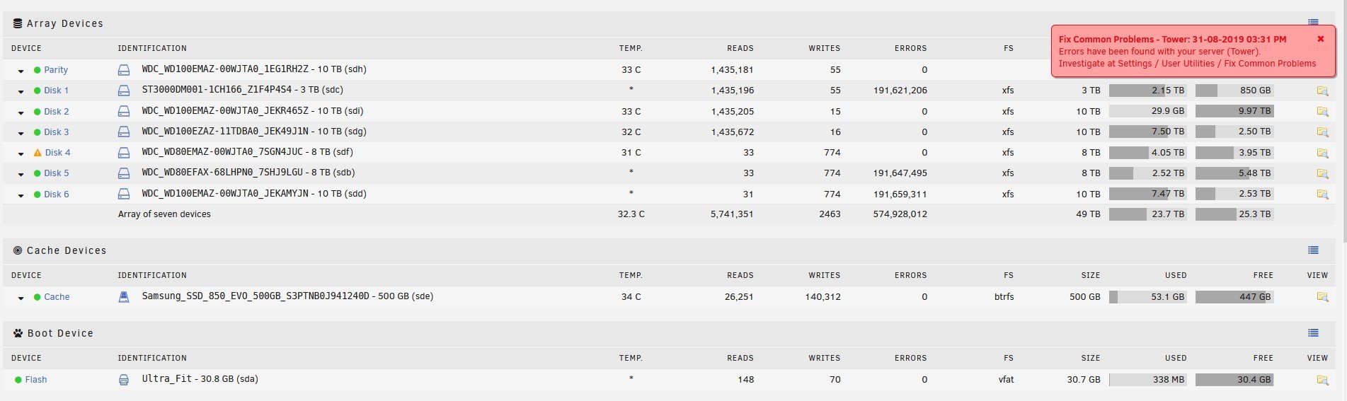

But immediately started to receive literally millions of errors.
Parity, cache, Disk 2, Disk 3 and Disk 4 are connected to SATA on MB. Disk 1, Disk 5 and Disk 6 are connected to an LSI SAS 9207-8i.

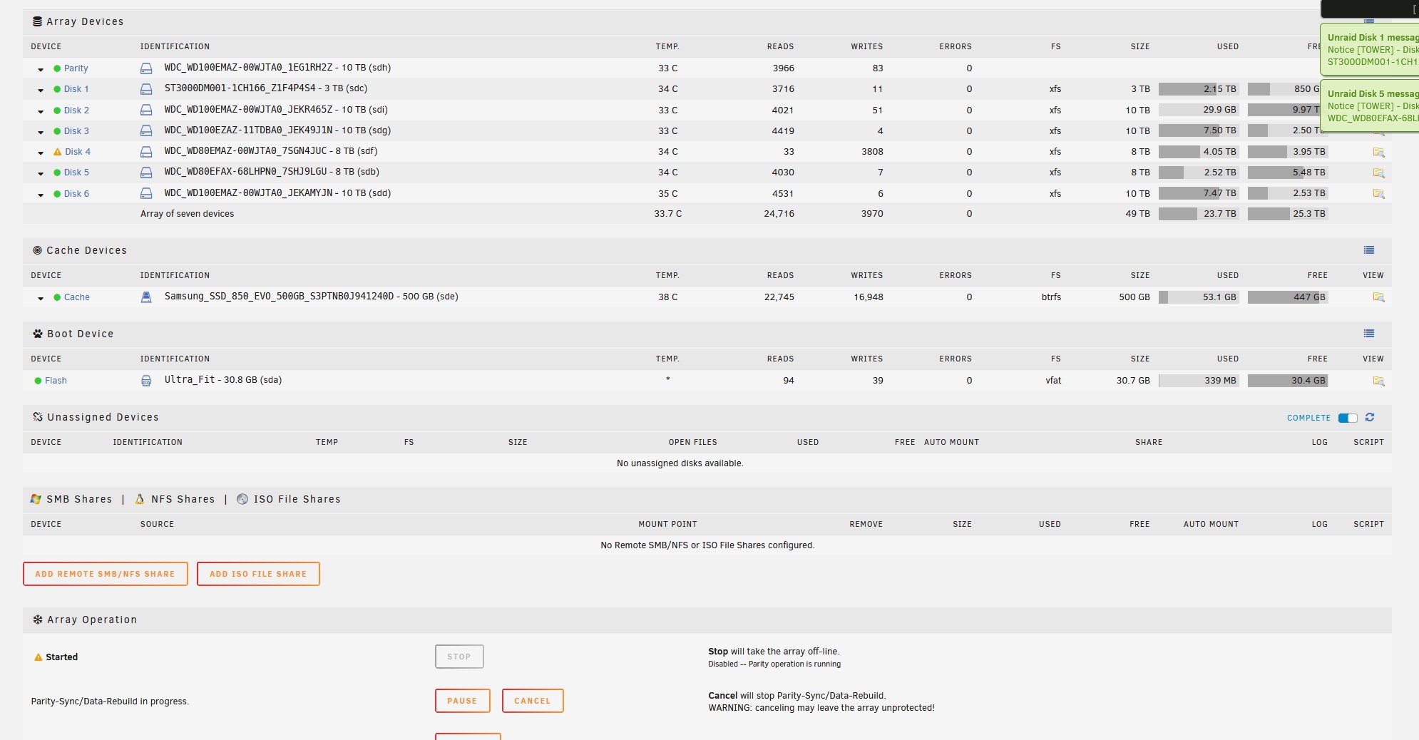

Disks 1,5,6 are all disconnected. Are these on the motherboard or the LSI? No point in continuing with a rebuild when other disks can't be read. All disks must be reliably read to reliably reconstruct a disk.
Looks like the webUI is working from your screenshot, so it shouldn't be necessary to get diagnostics at the command line as suggested. Just go to Tools - Diagnostics in the webUI.
Check all connections, power and SATA, then post a new diagnostic.
That would be correct.  1, 5, and 6 are all on the LSI.  All the other drives are connected to the on-board sata.  Attached is the diagnostics.
Thanks for your help.
tower-diagnostics-20190901-0151.zip

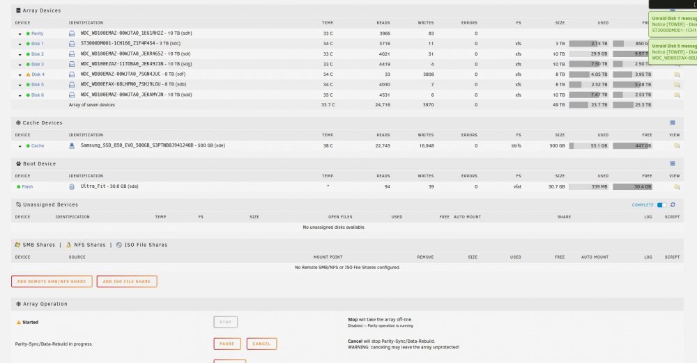

Update:
TLDR: the PCIE x8 slot on my motherboard is bad.  Moved controller to PCIE x4 and is booting without issue now.  All drives are showing up.
Further Explanation:
So I'm still not sure what happened with Disk 4, which is connected directly to the motherboard.  But user trurl had good advice and after unplugging/plugging in the various drives, cards and accessories, it looks like the LSI controller is causing the boot issues and disconnected drives.
about 50% of the time that the controller is inserted the computer won't POST.  This is with no drives connected to Controller.
Sometimes it will post and start to boot to OS, but hangs on "starting SAMBA" and listing drives.  And sometimes if fully boots to the OS.
With the LSI Controller removed it boots to the OS 100% of the time.
Moved the controller to the PCIE x4 slot and the PCIE x 16 (GPU uses this slot) and booted numerous times in each slot without issue.  So it looks like the PCIE x8 slot on my MB is bad.  Now booted and rebuilding the Disk 4.
Thank you everyone for your help.
