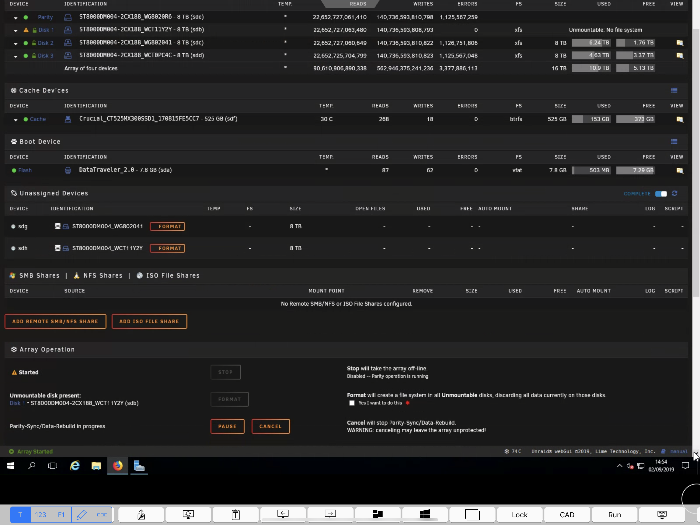

I ran it again. I’ve attached a screenshot. 2 drives have appeared as unassigned devices.
Will look at removing that message that floods when I get in from work thanks for the advice.
Excuse the screenshot from an iPad. Best I can do whist in work.

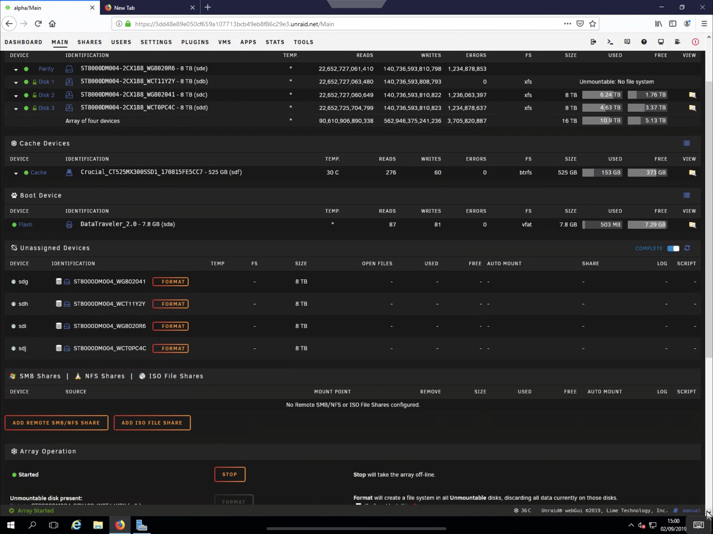

It’s just finished the rebuild and the drive is still listed as unmountable and now I have 4 unassigned devices.
No idea what’s going on.
No point in rebuilding with errors on another disk(s), likely a controller/cable/power problem.
