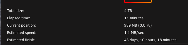

September 2, 20197 yr Hello - I'm seeing very slow speeds during a rebuild and I'm wondering if it's simply my setup, as I'm new to this. I'm seeing about ~1.1mb/sec to a esata enclosure with 3 drives off of a PCIe card. I don't have much data yet, but am seeing about 40 days to rebuild. Is this normal? Thanks tower-diagnostics-20190902-0317.zip Edited September 2, 20197 yr by RayD
September 2, 20197 yr Community Expert You are getting continual reset and subsequent retries on a couple of the drives and that explains the slow speed. Normally with a standard SATA connection one would suspect a cabling issue, but in the case of an eSAtA enclosure I am not sure if this is still the case or whether the issue is with the enclosure itself.
