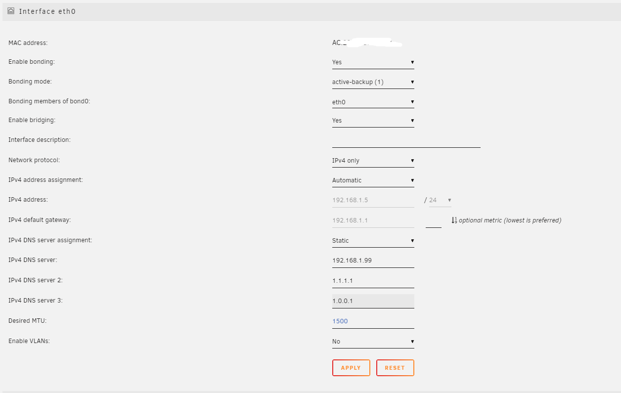

Hmm where would I change this?
Are you talking about this section as shown here? That 192.168.1.99 is the PiHole DNS

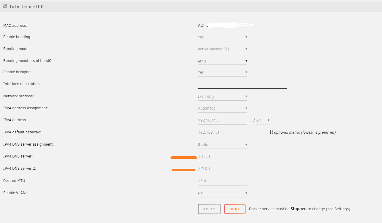

Would I change it to this?

Following @bonienl's recommendation (hopefully this was what he was talking about, let me know mate :)) to change the unRaid DNS to 1.1.1.1 - 1.0.0.1 in the section below does seem to have fixed this issue. PiHole is now blocking ads across the network (as it did before) but only this time PLEX and any internet bandwidth required for unRaid is at full speed from what I can see. PLEX thumbnails/icons are loading instantaneous across all devices, Community Apps loads instantly too.
