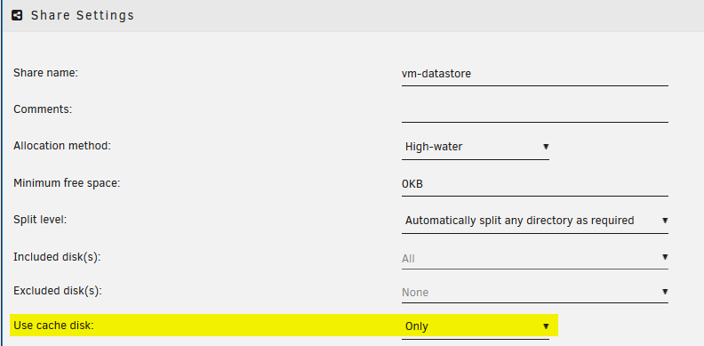

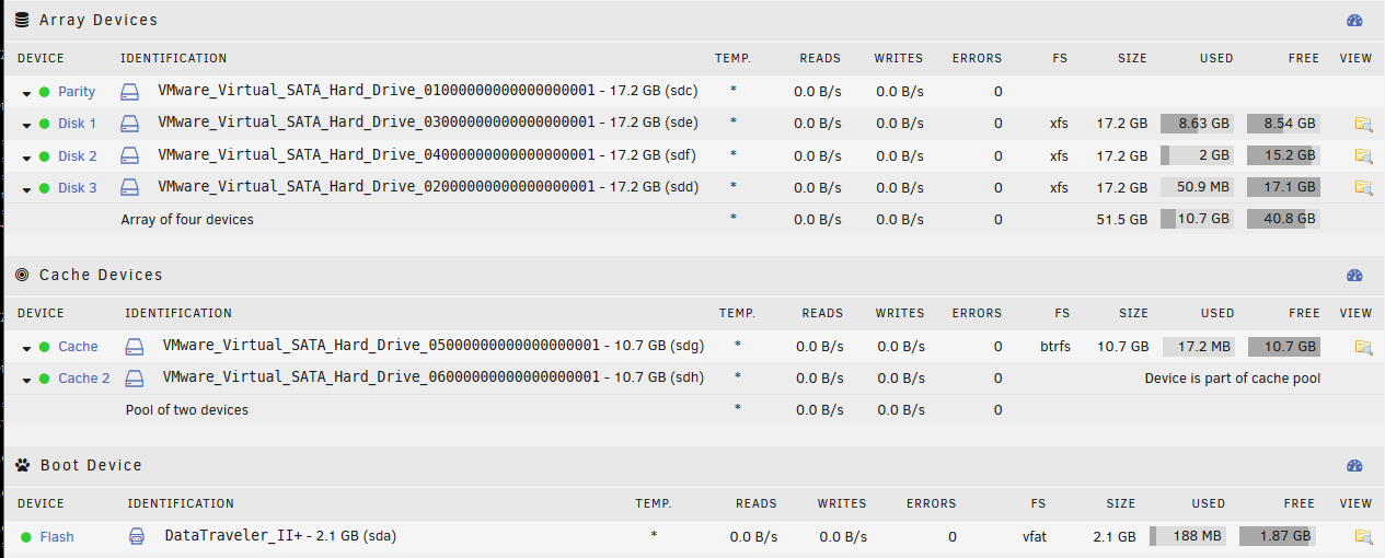

I published three more SSD disks to my "lab" Unraid VM, have assigned them as cache devices, and created a "vm-datastore" share that is set to *only* use the cache disks. This was how you meant, right?
Is the cache on btrfs RAID1 now? A bit unclear, but I assume since it's part of the cache pool it is.
How would I do to change this to RAID5 instead? I tried adding more disks, but there was some manual configuration also.
What if I want the cache to also be used to speed up the remaining shares. Will it risk becoming full from changes? Can I set aside part of the cache for one share?
