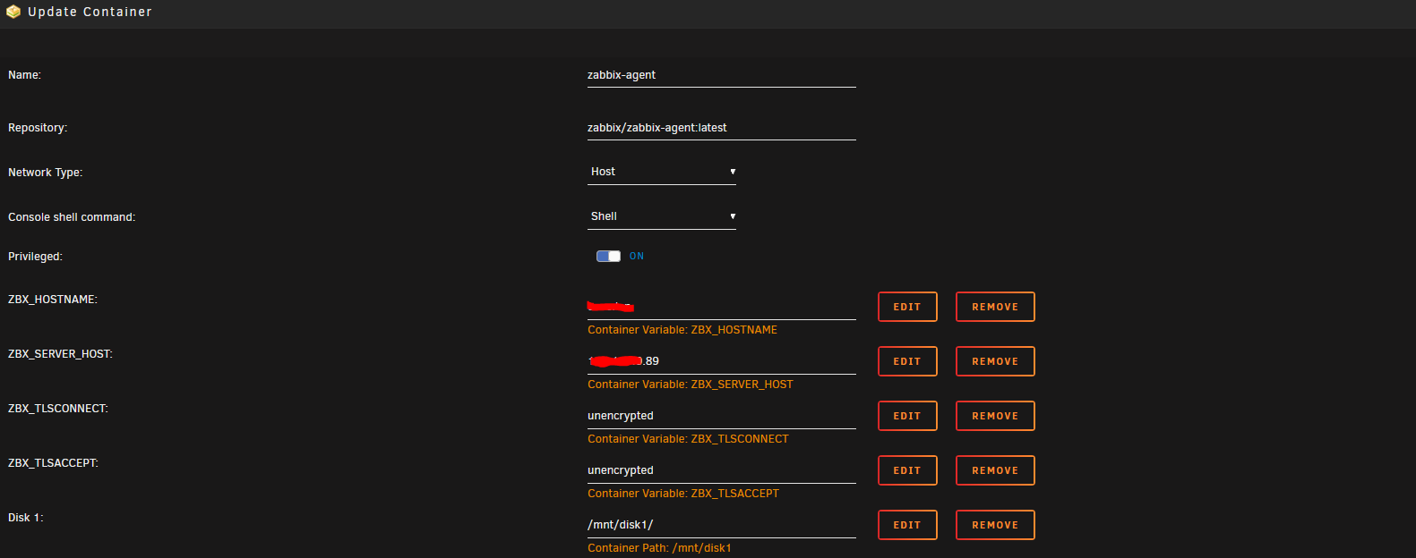

So it seems that with doing a bit more of a play around I can get the docker Zabbix Agent to work.
See the image attached.
As you can see to add disks it is a bit of a manual task each disk has to be added as a path to the docker.
The only trigger within Zabbix I had to disable for my unraid server was "Lack of Swap" as it seems unraid does not make use of swap memory.

I guess a template could be made with a default of x amount of disks and cache added. I am unsure on how Zabbix would treat a disk that isn't actually there. (I will have to test this.)
Okay so after a quick test:
I added /mnt/disk6 and /mnt/disk7 as paths within the Zabbix Agent docker (My server has no disk6 or disk7 installed).
I then ran a manual discovery check within Zabbix and as hoped it only found the actual disks that are there.
This means I expect the best method would be to create the template with the 30 disks max and the 1 cache. If @trurl could provide some assistance on how to and where to submit a template I would be happy to create it.

My docker I created has all 30 disks and cache added like my XML template.
I have not noticed any large spikes in RAM. The current RAM usage of my Zabbix Agent docker is hovering around 6.8MB - 7.2MB
