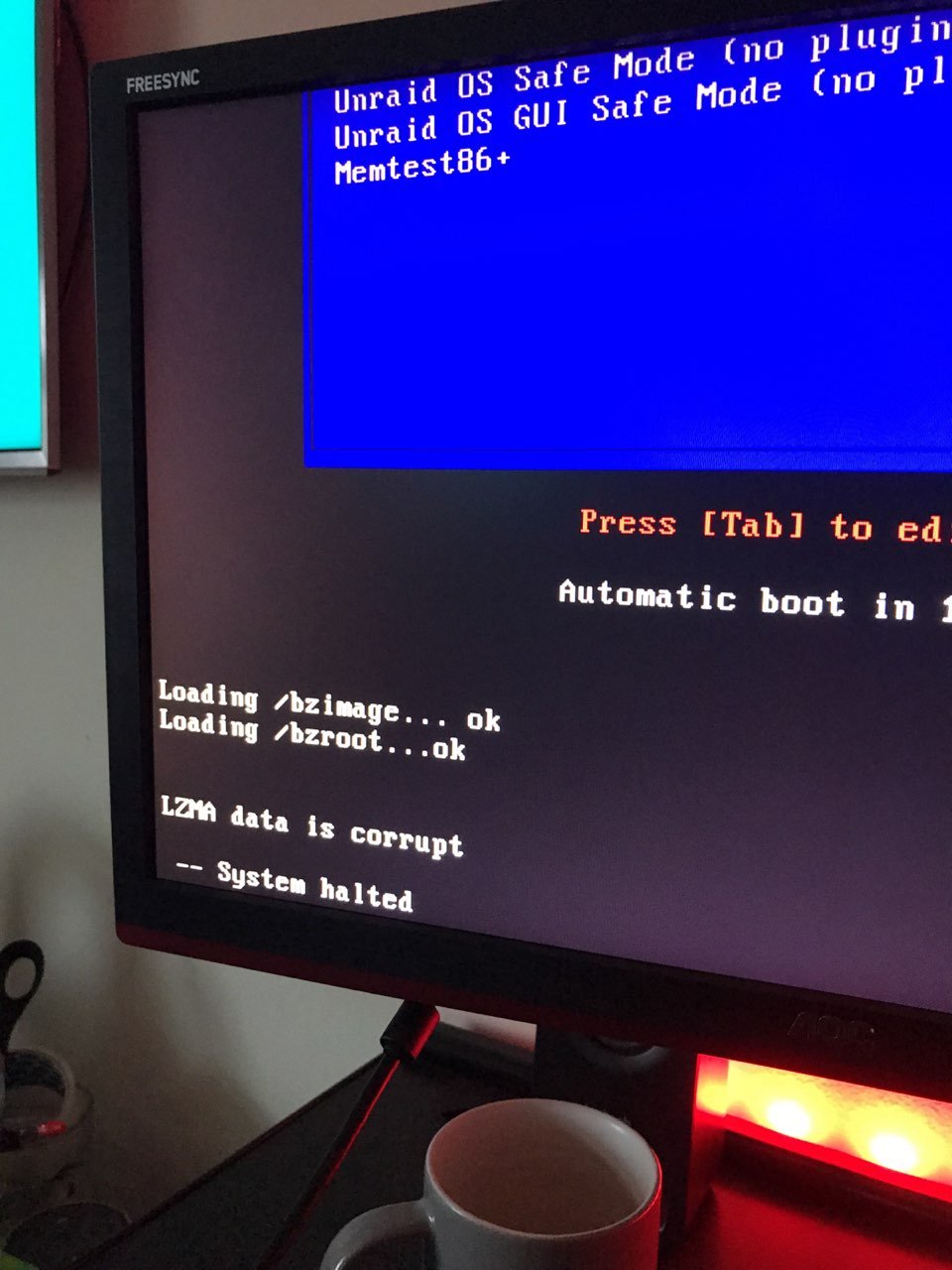

I'm having issues booting, every time I reboot the Unraid Server I get "LMZA Data is Corrupt. System Halted" when booting.
At first I thought it was the current USB (Its old) So I bought a new Kingston 8GB USB, Used the USB Creator tool to deploy the backup onto the stick (as per guide https://wiki.unraid.net/UnRAID_6/Changing_The_Flash_Device

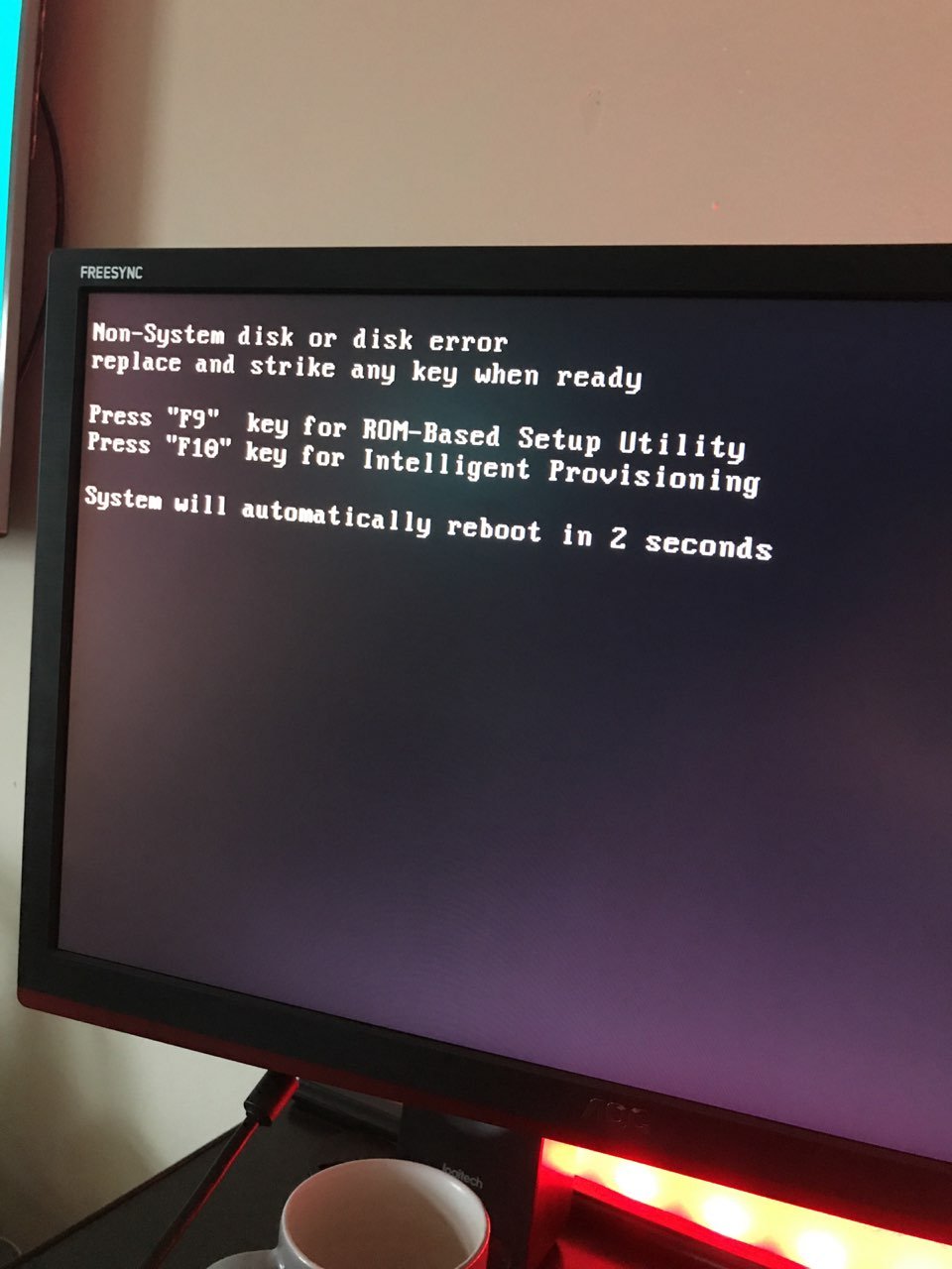

So After the above I now get  "Non-system disk or disk error"

As mentioned, So I downloaded the unraid files of the site, copied over the bz* files and put that in and its booted with no issues.
However after a reboot I get the following;
So I Thought the USB must be on its way out as its old and could be dodgy. So I took a backup of the USB and created a backup USB using the unRAID USB creator.
So I boot the New USB and get the following;
I then thought this was a disk issue and tried to run the makebootable as admin. but the same happens.
