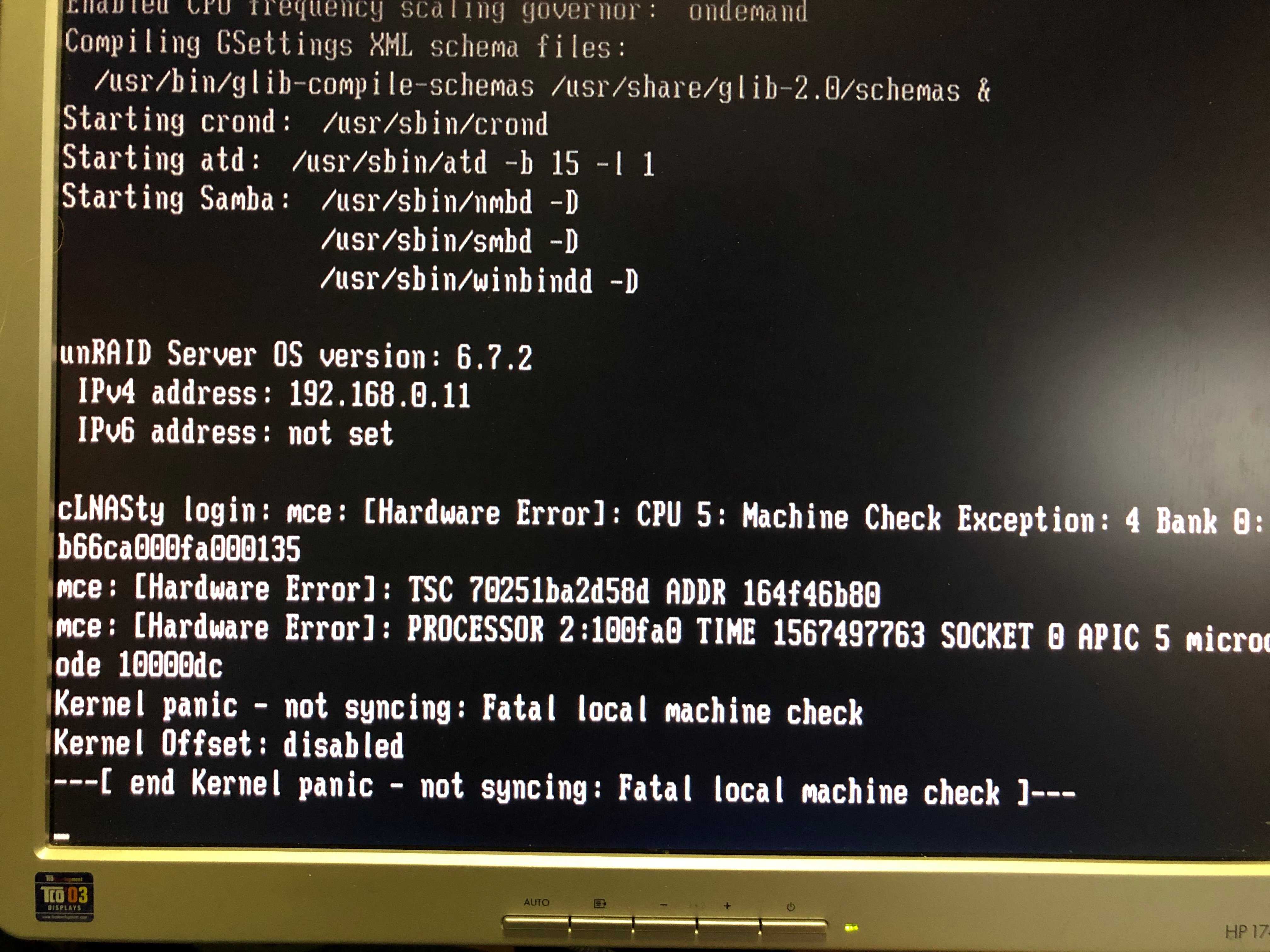

Hi all, my unRAID hung a couple of times, with some months of troubles, ranging from disabled disk (8TB)  Toshiba drive that was installed new, but suddenly becoming disabled. I uninstalled the disk in the array and whilst it is in place, I ran the pre-clear, than let it rebuild. Took two days to do it. That was the first time. This time is the second. During the pre-clear, the unRAID hung with this error (attached image) on the console. I downloaded the diagnostics file for your investigation. On an end note, is it because my mobo & CPU is acting up and need a replacement?  Any advice is much appreciated.

Try memtest from the boot menu, preferably at least 12 - 24 hours worth.
Okay, will do. I need to finish pre-clear and rebuild before going into this. The old mobo + cpu had been serving me for a good decade! Thanks for your advice, jonathanm.

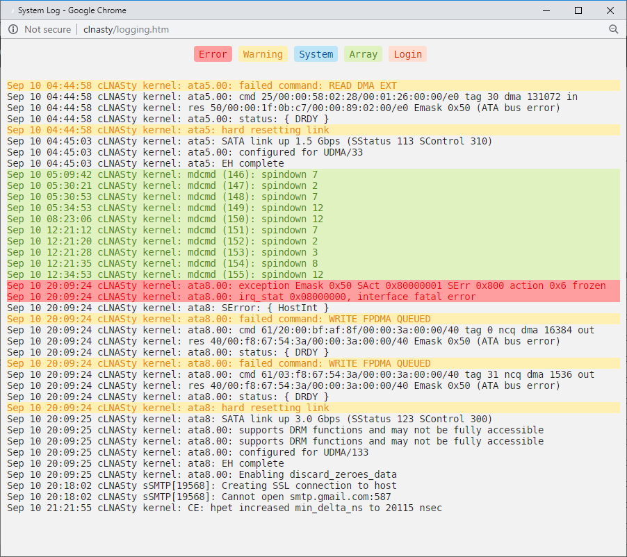

Still not able to do memtest as I was busy. But this is a look at my syslog screenshot. Can you interpret if this patient is having bad news?
