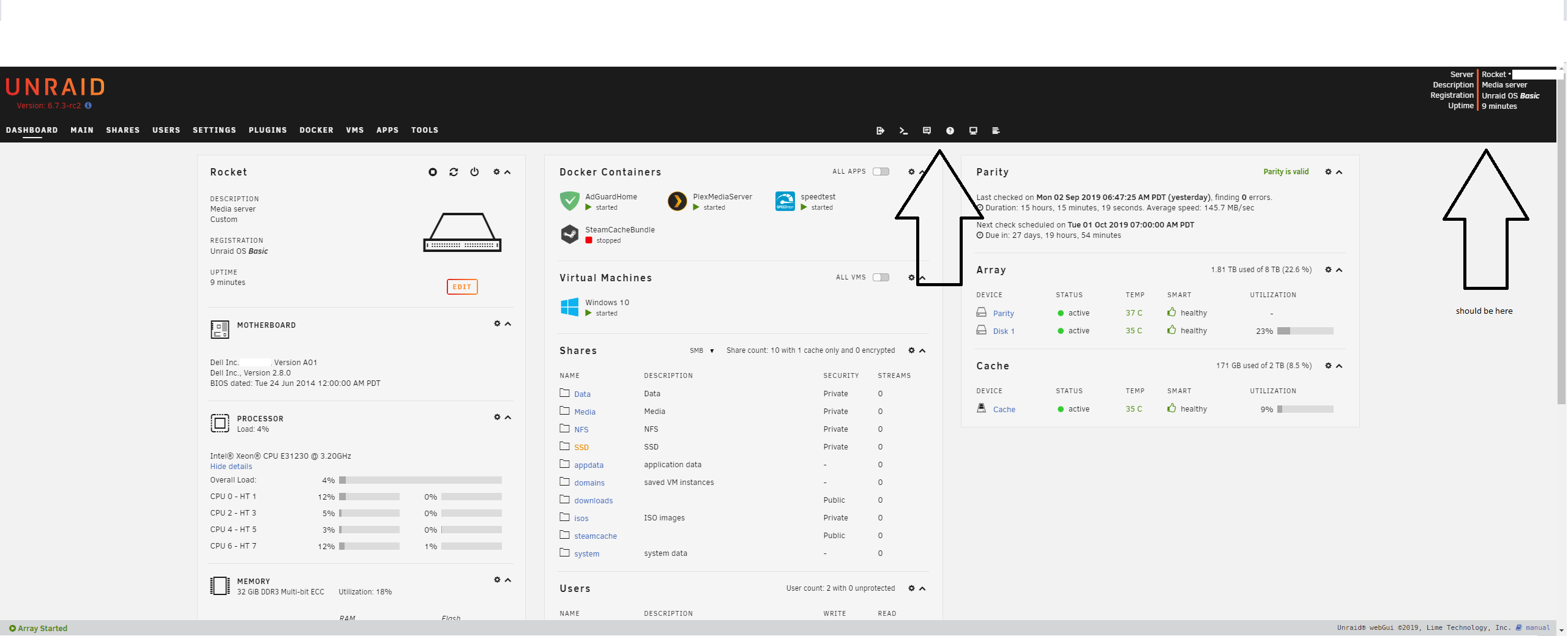

Buttons in the right upper corner are not scaling well
What bowser are you using and what is the monitor resolution?

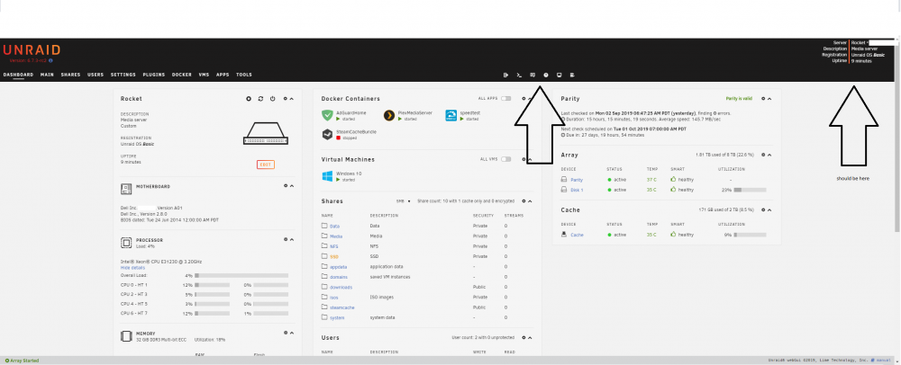

i used Chrome, Edge ,IE (2560x1080) i tested 1920x1080 same thing. the buttons go more to the left on 1920x1080 (i never had that before)

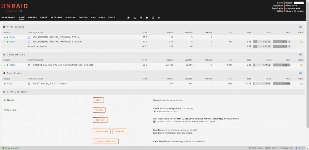

Screen shot (1920x1080)

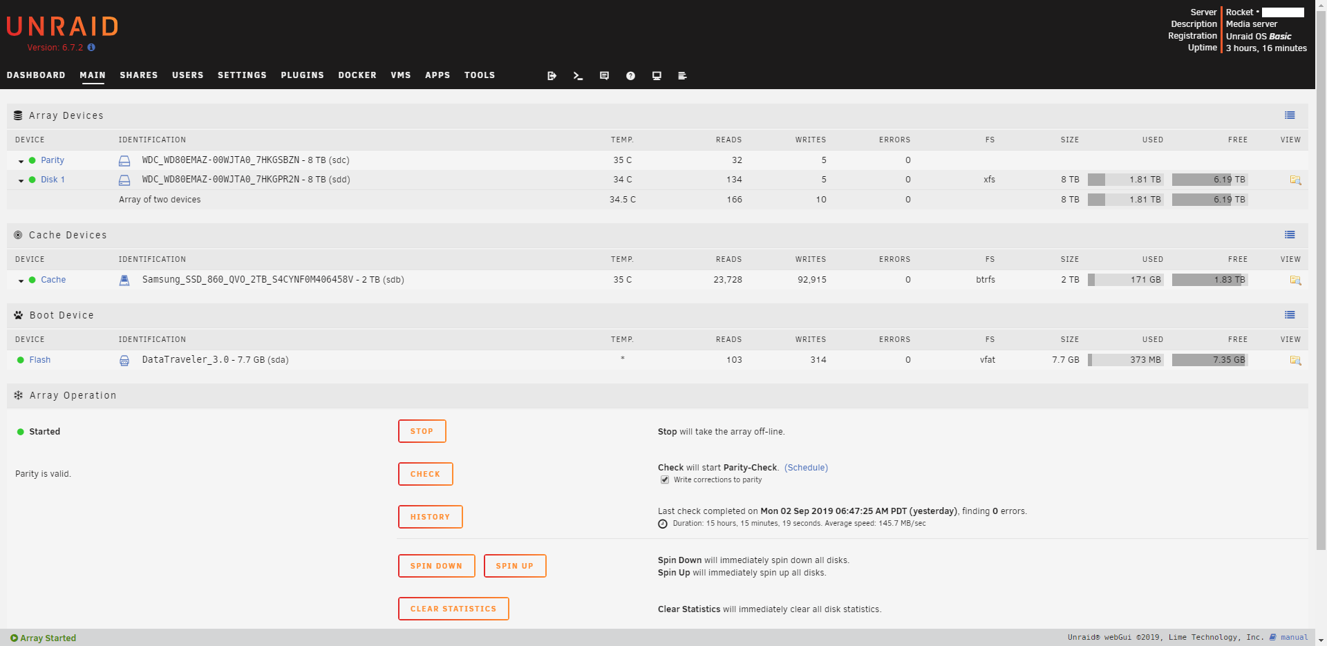

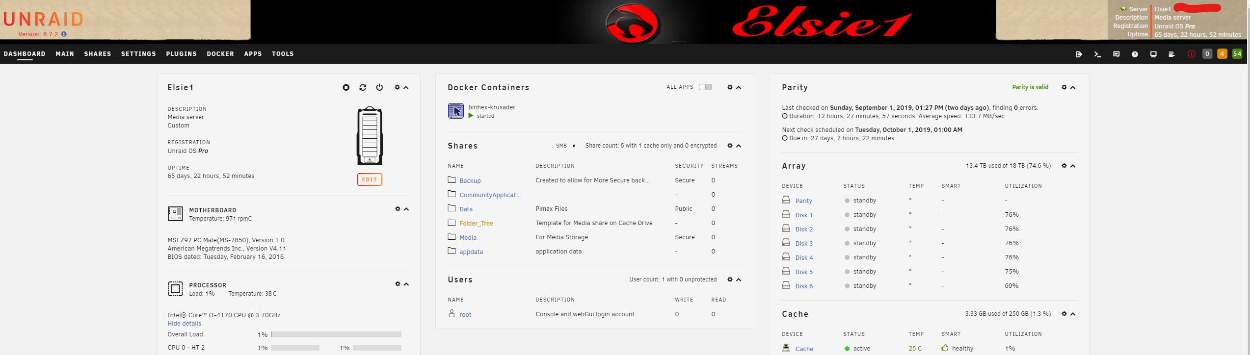

I have a 2560X1600 monitor, Google Chrome,  and this is what my full screen capture looks like:
yes thats good ;) , i think something is wrong with my unraid. but no idea how to do a file check. you have any idea ?

Does it do the same thing on the release version? You seem to be running RC.
Yeah does the same thing, i tested both. (My first usb did not boot after a normal reboot. So i used a brand new one. And Made a new installer With the backup.zip that i downloaded from the server 3 weeks back. If maybe something is corrupted i do want to reinstall the stick. But no idea if i can add the hdd’s back and ssd With outh losing data. (Sry for bad eng)
