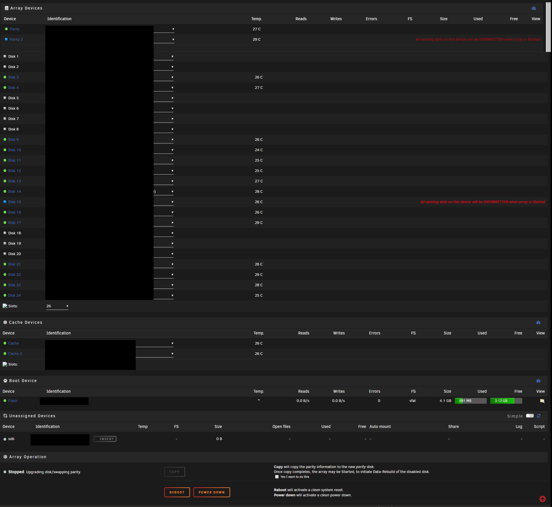

So I decided to do something I guess kind of dumb and now I'm not sure how to proceed again. I think I know but would like to be sure.
I did the parity swap, and unraid copied the data from my old parity to my new parity with the array offline. That operation completed and then I was presented with a stopped array. I had valid parity and starting the array would start the rebuild of disk 15 (overwriting my old parity). That's all well and good.  But I moved the 2 drives around the server physically, with the server on and array stopped (as I have hot swap bays). That pissed off unraid.....In hindsight I think if it did it with the server off it would have been fine and moving them physically shouldn't mater to unraid correct?
So if I assign my old parity back to the parity slot and leave disk 15 unassigned its happy. It's back to before I started the parity swap and copy procedure. I then start the array, then stop the array then continue with the parity swap/copy procedure again.  I would suspect this will work 100% as it will just copy the parity again (unnecessarily really). After the copy is complete, start the array and let it rebuild disk 15.
But I think there is a way to assign the new parity drive and tell it to trust it. Then build disk 15.
Essentially I know I have 2 parity disks that are the same due to the parity copy procedure. My new parity and old parity drives should be identical. But unraid wants to "All existing data on this device will be OVERWRITTEN when array is Started" on my new parity, even though it should be valid since its a clone of the old parity. I'm about 99% I can't use new config as I'll loose parity and the data on my failed disk. I was thinking more of a trust parity but I don't see that option.
Option one seems a lot safer but a bit longer so I'll likely end up there but would like to know if option 2 really exists.

Unraid then marked both disk as new (blue square) and said "All existing data on this device will be OVERWRITTEN when array is Started" on both disks (parity 2 and disk 15)
The only way to correct the above issue is to change the assignments back to before the parity swap happened. If I assign disk 15 back to parity 2 slot and unassign disk 15 from slot 15 then unraid reports "Configuration valid'.
So I think the obvious process would be to basically start over. Start the array without disk 15 assigned to a slot. Stop the array, add the new disk and perform parity swap/copy. Then start the array as I should have done. Without moving anything.
What I think happened is unraid saw the disks disappear when the drives were pulled out. For some reason it seems to have forgot the parity swap/operation happened. I suspect if it had powered down the server then did the move unraid would not have cared. But that's only a theory.
Not sure if something weird just happened or this is a "bug" or a note should be added to the procedure. It would need to be replicated of course but it would be simple. Do a parity swap then unplug and replug while powered on and see if unraid forgets that the parity swap happened. So the note would just be to not make any changes until the array is started at least once.
Well I decided to try and start over. Started the array with a valid config which like I said was going back to before the parity swap. Which is disk 15 back to parity 2 slot and disk 15 unassigned. With the array up everything was fine disk 15 was emulated and I have valid parity on both parity drives. Now I was going to start the parity swap again but I don't know if this looks right. I didn't think disk 15 had the "data will be overwritten" warning (disk 15 being the "old" parity 2)
Please confirm this is expected on a parity swap and I'll proceed. But it looks wrong and like I would have data loss. (loss of data of disk 15)
*Note, this is what I saw after moving the disks around and why I was worried to start the array. As the data on disk 15 (old parity 2) needs to be copied onto parity 2. If the data on disk 15 is overwritten then the parity info is lost. So this looks wrong.
The ironic thing here to me is both disk 15 and parity 2 are currently identical as the parity copy operation finished. Assign either to parity 2 should be fine but unraid won't allow the new drive to be assigned.
Edited by bnevets27

Since I know I'm starting over, I'm going to perform the parity swap/copy again. The server is currently in the above state waiting to start the process. But I want to confirm that seeing "All existing data on this device will be OVERWRITTEN when array is Started" on both disks is the expected behaviour. It really feels like it shouldn't be what is expected.
It is, first parity disk will be overwritten with old parity, then disk15 will be overwritten by the rebuild.
Thanks Johnnie. That makes sense but I had thought I had not see it shown like that (both disks as "new"/blue) the first time I did the parity swap/copy. From what I've gathered the copy operation happens then the array stops and then you have to bring it online to rebuild.
So during the copy, the old parity (which in this case is now in slot 15) is writing to the new parity in the parity 2 slot. Disk 15 during this operation isn't getting written to. Now after the copy operation happens the array needs to be started, when the array is started that's when the data on disk 15 is overwritten. I know this is minor details but having the correct information in the GUI would help understand what is really happening.
Started the parity copy now, and I won't be doing any changes until I start the array this time. Thanks to both of you.
