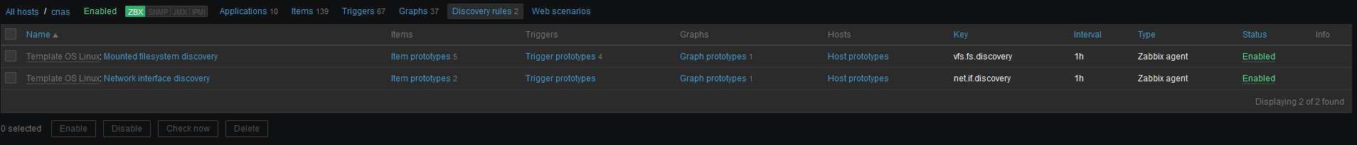

If you would like to force a discovery check then you can do the following from the Zabbix WebUI
Configuration > Hosts > Select relevant host > Discovery rules
You should then see the below:
You can then click the relevant box for your rule you want to force check (In your case I would just select both)
Once selected you can click the check now button. This will force Zabbix to complete a discovery check on your host.
Please do let me know if this works 😉

I checked the settings now under discovery rules. And both of them says “Not supported”. And then there is a info box why it’s not working. It says “Cannot find the “data” array in the recieved JSON object.”
Does that error say something to you?
Edit: My Zabbix version is 4.0.8
46 minutes ago, Sic79 said:
Ok, thanks for helping emoji4.png.
Ah in which case that last part would make more sense as to why this does not work.
The agent provided is using the latest tag, and the latest tag currently is Agent version 4.2, which isn't backwards compatible with 4.0.*
I would suggest updating your Zabbix server to 4.2 minimum and it should work. (My Zabbix Server is on 4.2.6)
Sorry for not making this clear in the main thread, as such I have updated the main thread post stating that this is Agent 4.2 and the minimum sever version.

Updated server to 4.2 now and it worked instant :)
