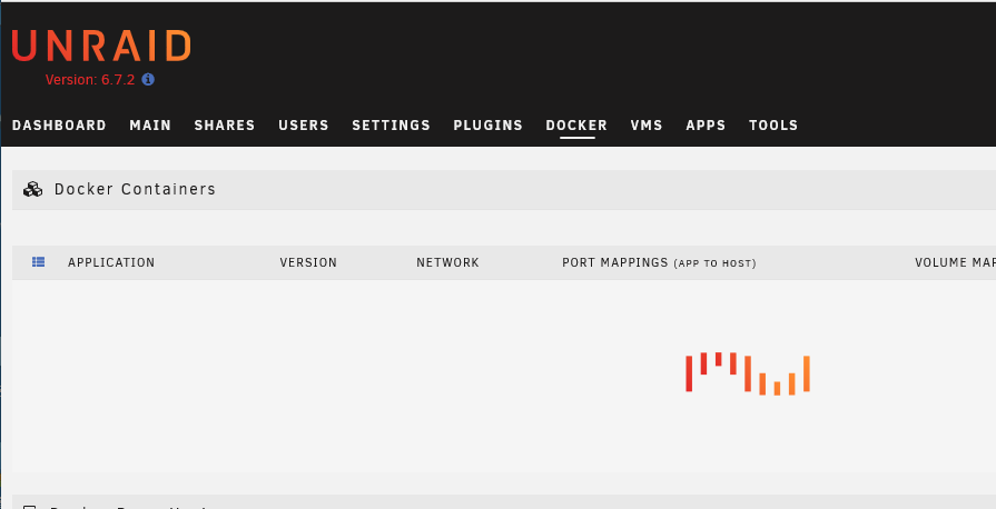

I can't open the APPS page. I need help.
I have a problem with the trial version and need your help.

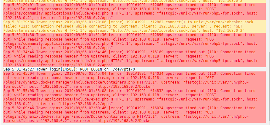

https://forums.unraid.net/topic/38582-plug-in-community-applications/
I suspect your problem is due to your server not being able to reach the internet.
Go to Tools - Diagnostics and attach the complete diagnostics zip file to your next post.
I'm sorry, I put it in the wrong place. I had two identical problems and the docker page couldn't be opened.

Are you sure your server can reach the internet?
What do you get from the command line with this?
ping -c 3 google.com
Hello, I'm in China. I don't need to try this command to know that my server can't connect to google. But it can connect to the internet.
The result looks tragic
