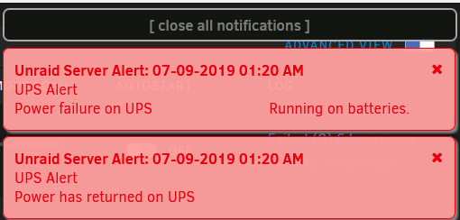

I installed a new inverter to help my ups during extended outages (I have a lot of mains outages every day) and now my power topology is:
100AH inverter (10ms transfer time) --> 1kva APC double conversion ups /w snmp network card (no transfer time) --> load
before, I had an extra double conversion ups and it was powering my main APC ups and since the extra ups had zero transfer time, I didn't get power failure ups alerts when AC fails.
but now, since the APC ups is powered by a line interactive inverter, I get a consecutive power failure and power return ups alerts on unraid every time the AC fails or returns.
so my point is that this may have triggered a bug in apcupsd that caused the server to shutdown
