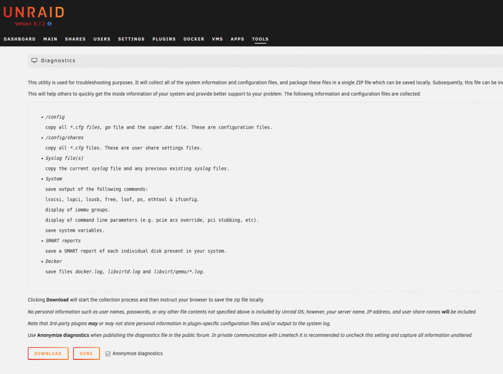

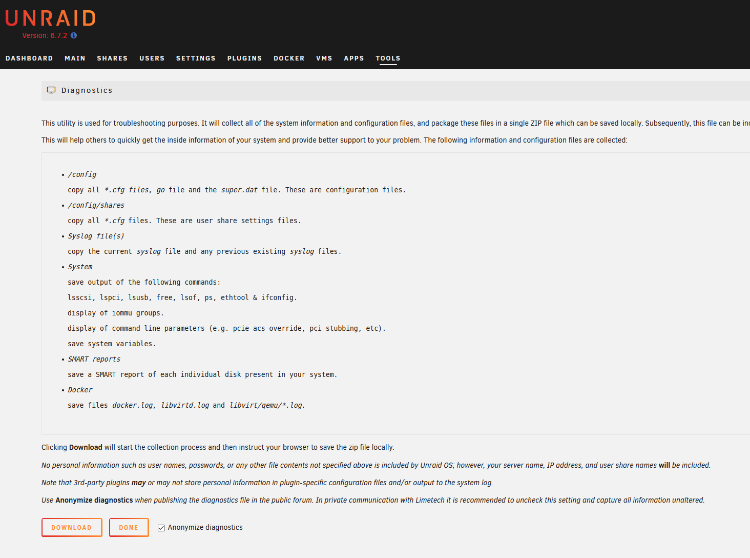

OK, I was able to format without taking it out of the array. It only took a few seconds, and I am getting the same readout of Unmountable. Are these the diagnostics I should post?
Try again after rebooting, since there were some issues with disk2, which might be failing in case you didn't noticed, if still the same please post new diags.
Not seeing a format attempt.
