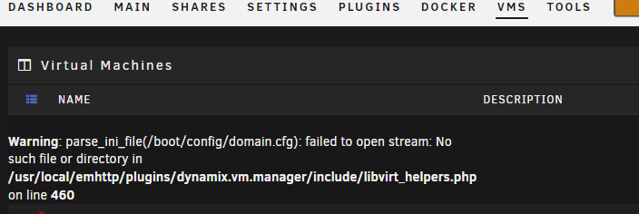

After some time i wanted to start my Win VM - (its via Real M2 SSD and spaces_win_clover.img), but soon as i start it i get this error:
 No such file or directory in /usr/local/emhttp/plugins/dynamix.vm.manager/include/libvirt_helpers.php on line 460

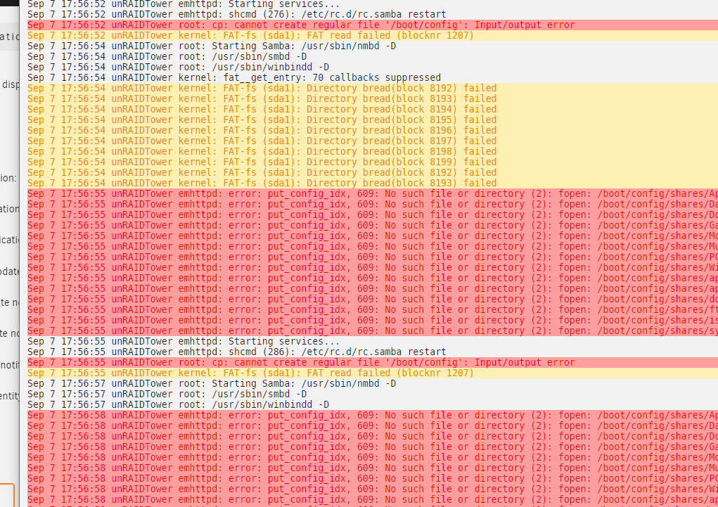

Log start to throw such errors:
Then unRaid USB fall out and i need to reboot server...

Always post your diagnostics before you reboot, as that is what will tell the story.
But, based upon your screenshot, your flashdrive dropped offline.  Use a different port if this reoccurs, ideally USB2

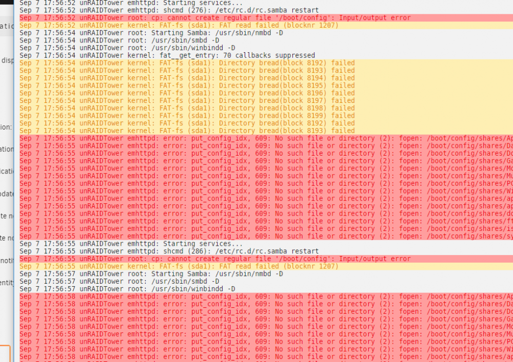

Ok re-adding diagnostics after the error occurred.

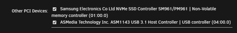

Once again the flash drive dropped offline.  Are you trying to pass through a USB controller to a VM?  Are you sure that you're not passing through the controller that the boot stick is connected to?
I just tested your suggestion...
I probably changed the USB position by server move and the USB Controller pass through might cause the outtage.
