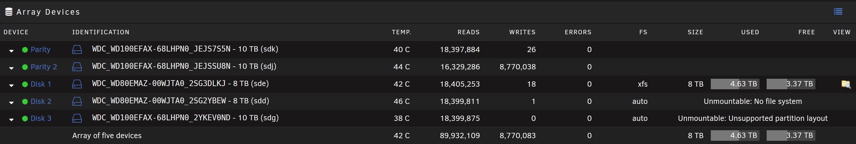

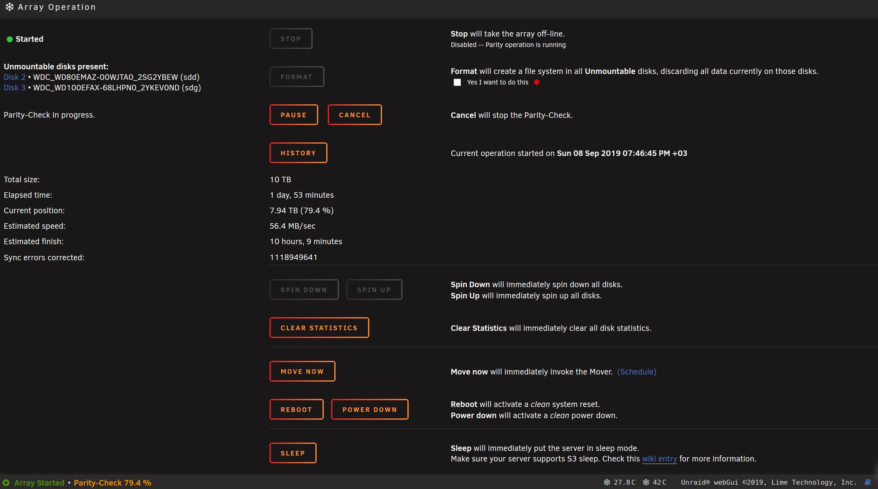

so i started the Operation for upgrade yesterday following this guide did the new configuration did a maintain only for cache and data drives only
move the old parity drive to the data drives as second one and didn't format it yet and add the third drive as the 10 tb and both the new parity drives
and did the Parity-Check it will take 1 day and 7 hours ( only remning now 9 hours the speed go up and down from 57.9 up to 129 )
am now at 78 % done , but am worried about the Sync errors corrected : 1099825108 is it normal to reach after an upgrade like this ?
here is the diagnostics file and screenshots hope it helps

Adding ScreenShots
Let the parity sync finish.  I seem to recall that the Sync errors are a common occurrence as this is the first time that parity has been calculated for these disks.  The speed will increase after it gets done with the 8TB data drive.  (I didn't look it up but I would suspect that it is a shingled drive.)
