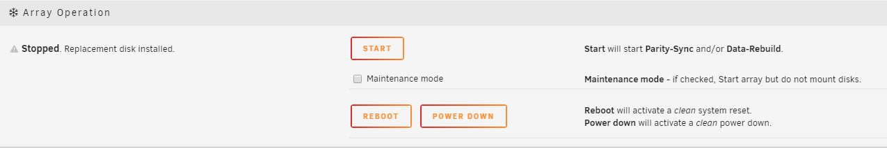

Correction - UnRaid Array Opertions is saying "Start will start Parity-Sync and/or Data-Rebuild" instead of asking me to format the drives.
Will this allow me to rebuild Disk 3?

No, you need to use the invalidslot command, follow the instructions below carefully:
-Tools -> New Config -> Retain current configuration: All -> Apply
-Assign any missing disk(s), like both parity disks (command below needs both parity disks assigned, it's different with just single parity) and new disk3
-Important - After checking the assignments leave the browser on that page, the "Main" page.
-Open an SSH session/use the console and type (don't copy/paste directly from the forum, as sometimes it can insert extra characters):
mdcmd set invalidslot 3
-Back on the GUI and without refreshing the page, just start the array, do not check the "parity is already valid" box (GUI will still show that data on parity disk(s) will be overwritten, this is normal as it doesn't account for the invalid slot command, but they won't be as long as the procedure was correctly done), disk3 will start rebuilding, disk may or not mount immediately but if it's unmountable don't format, wait for the rebuild to finish and then run a filesystem check

I have done as you said and the array now reports rebuilding disk 3 contents, let's hope. Shame the shucked drive was a desktop drive and not a WD Red but desperate times.
Thanks for everything will let you know how it goes. Still got the old drive on the desk if I need to do a recovery.
