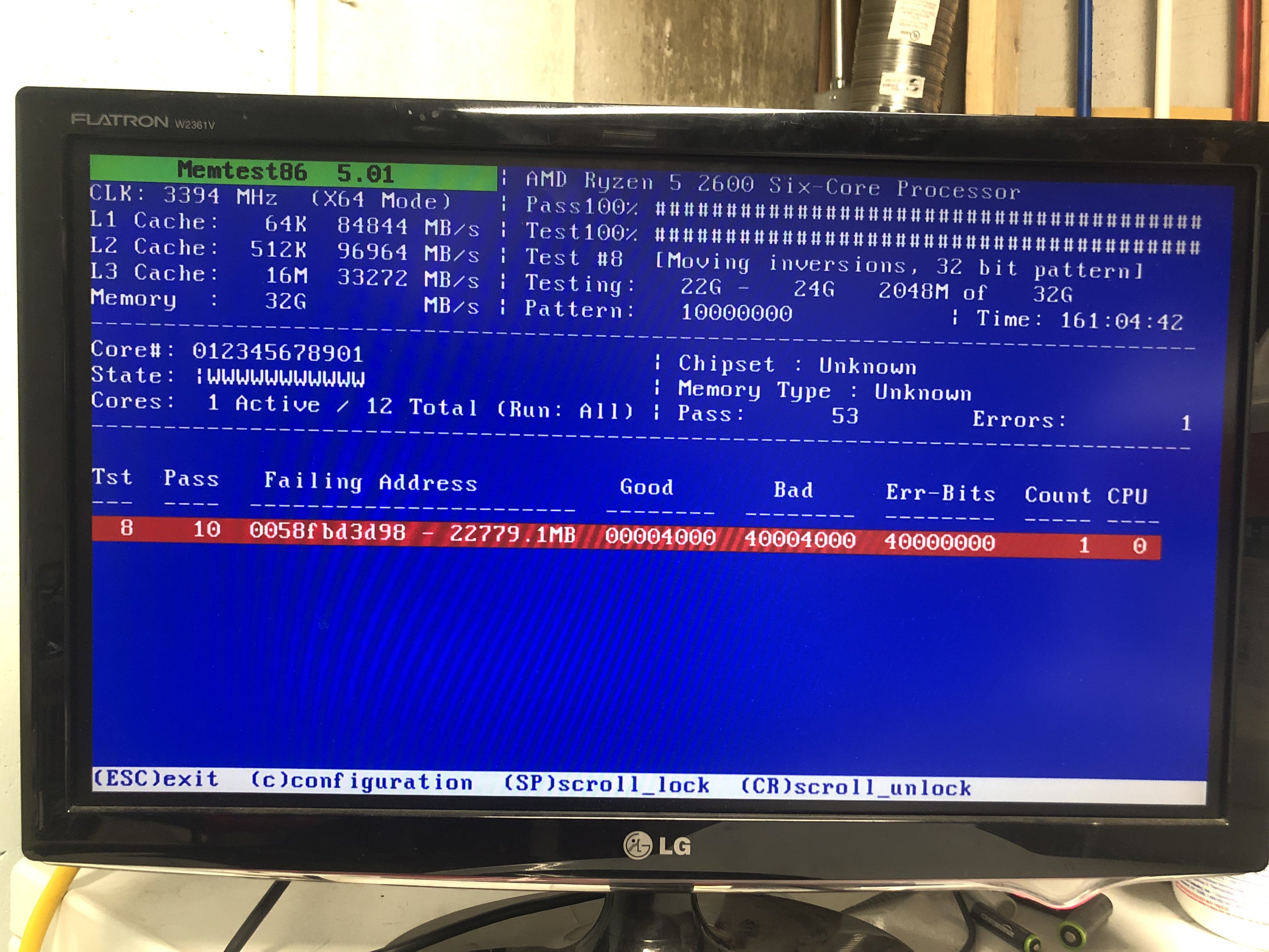

Hey guys, sorry I went dark. I was out of town. I started memtest to run over night and forgot to stop it and it ran for 161 hours before I manually shut it down. It accumulated 1 error well after the 24 hour mark.
Still not acceptable, make sure RAM is not overclocked, it's known to cause issues with some Ryzen systems.
As far as I can tell, memory speeds are unchanged by me and running at 2133. The sticks are rated for 3200. Here's the product page for the memory I'm using.
I've attached the screens for my bios settings
bios_screens.zip
Edited by jsmj
It appears so, so you likely have a bad dimm.
I've reproduced the issue when booting from each individual dimm by itself but I haven't run memtest with a single dimm installed. Is that worth doing?
Yes, like mentioned the only acceptable number of errors during memtest is 0.
