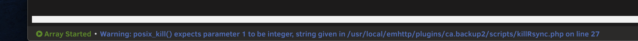

In an attempt to get more data, I installed a user script that tails the syslog onto the flash drive since I'm not able to get a log at time of crash. Regular diags as well as this log are attached. Around line 460, the system seems to enter an endless loop. On one occasion, I noticed a strange message about CA Backup in my browser status bar, of which I took a screen shot. All three files are attached. Any help nailing down this issue is greatly appreciated.
