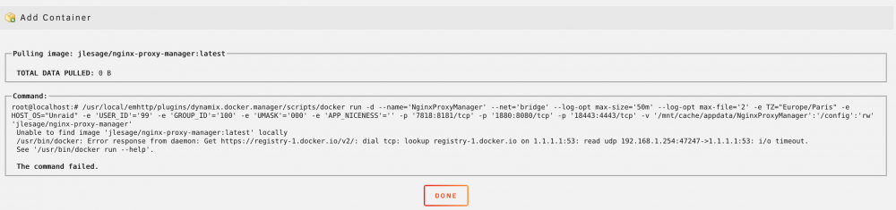

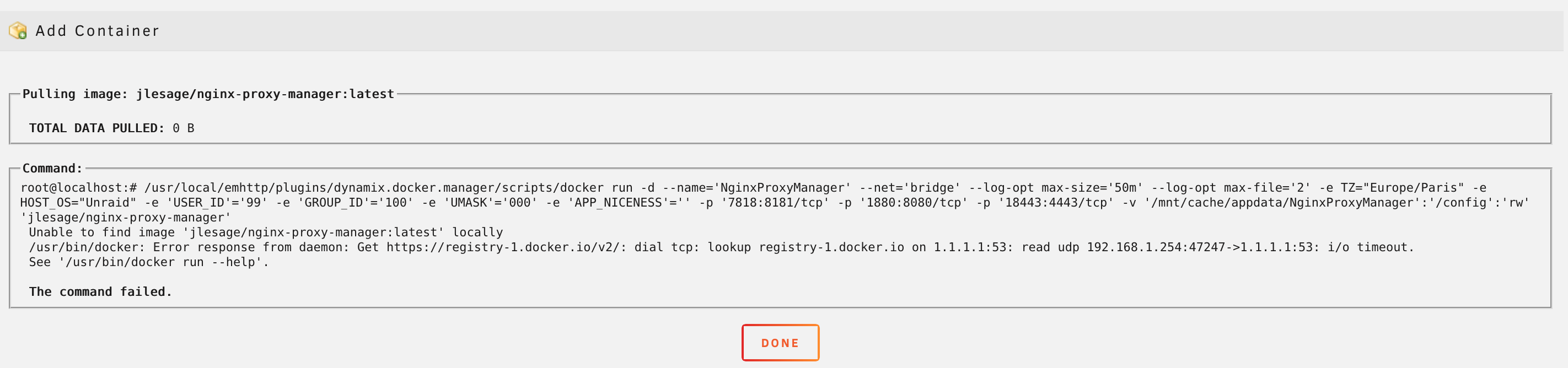

My Unraid can't pull any docker image from Community Applications (I can install plugins)

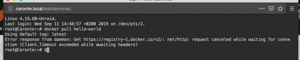

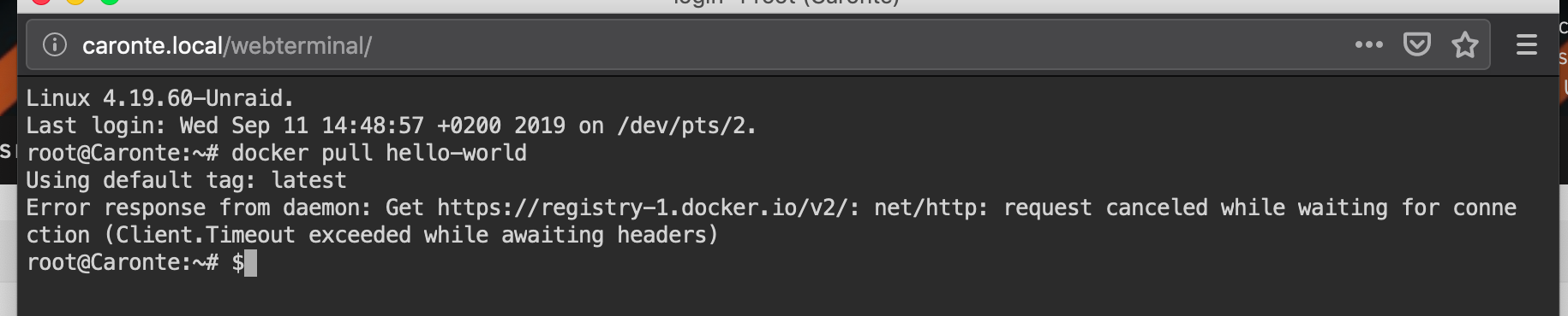

Neither from terminal (docker pull hello-world)
I know what you are telling me...'"Change DNS to 8.8.8.8"", I already did on Unraid, on my router... Same error result, but instead 1.1.1.1:53 it says 8.8.8.8:53

I figured it out by myself... and I think I found some kind of bug on how Unraid manages NIC's.
I just disabled secundary on board interface in the BIOS (My motherboard has 2 Gigabit on board), I did a reboot and voila. it's working
I don't know really why, but I think, it is related to this:
DOCKER_ENABLED="yes"
DOCKER_IMAGE_FILE="/mnt/cache/docker.img"
DOCKER_IMAGE_SIZE="25"
DOCKER_APP_CONFIG_PATH="/mnt/cache/appdata"
DOCKER_APP_UNRAID_PATH=""
DOCKER_CUSTOM_NETWORKS="eth1 "
DOCKER_LOG_ROTATION="yes"
DOCKER_LOG_SIZE="50m"
DOCKER_LOG_FILES="2"
DOCKER_AUTHORING_MODE="no"
DOCKER_USER_NETWORKS="remove"
DOCKER_DHCP_BR0="192.168.1.128/25"
That's my docker.cfg. Look at line 6:
With bonding enabled it was blank (it wasn't able to pull any data neither) and it filled itself with that value at the moment I disabled bonding, but it wasn't working, then I noticed that Unraid manages physical interfaces as eth0, eth1... Maybe that parameter was in conflict with my secundary NIC...
So I think that there is a bug related to that, maybe Unraid is not prepared properly to handle multiple NIC's and docker...
I would like to use the secundary NIC in a future, maybe I should experiment with that parameter, maybe setting it to eth2 does the trick.
I expect this info is useful to someone. Unraid doesn't like dual NIC 😜
Now I will keep testing the system, I like pretty much all till now. I'll probably buy one license when trial mode ends.
Edited by magonzalez112
Unraid can handle many NICs. My server has 7 NICs and several interfaces are dedicated to Docker. Other interfaces to VMs.
When a (new) interface is discovered upon start up, it will made available to Docker, but this needs to be configured in Network Settings and Docker Settings.
Perhaps you had something configured wrongly in either network or docker settings (after bonding was disabled).
