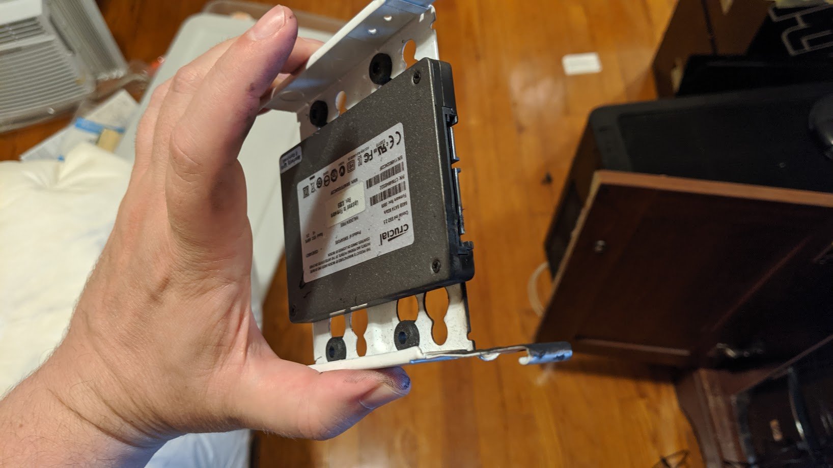

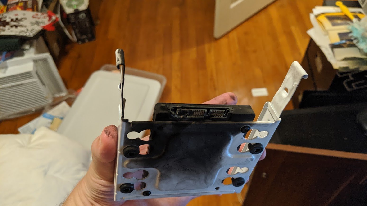

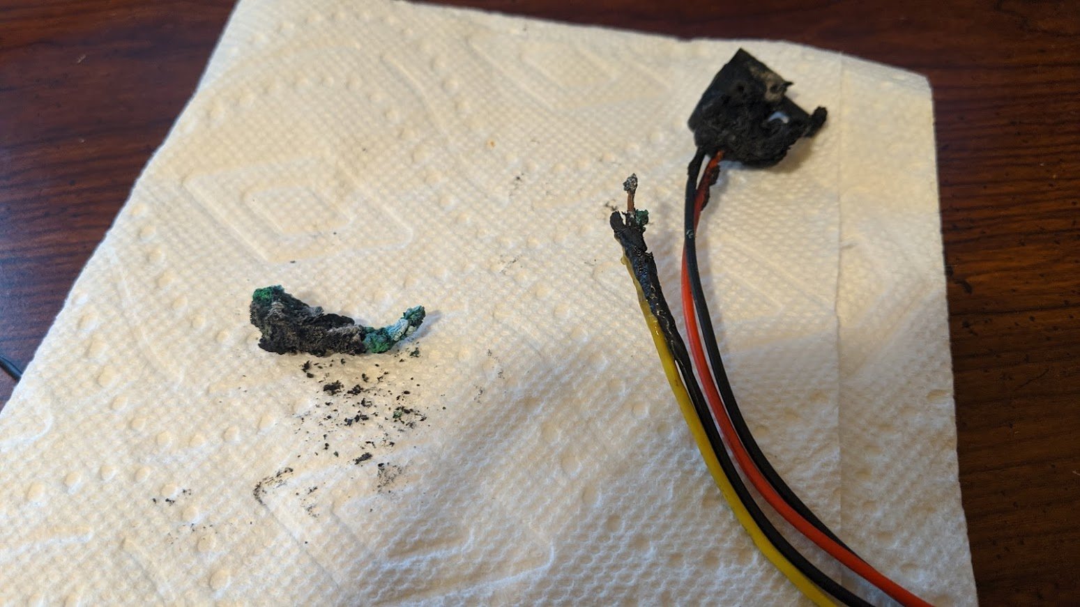

So I found out why my cache drive failed!  Looks like a cheap molex to SATA connector melted and caught on fire!
If any other folks see this, please learn from my mistake and use better connectors - crimped connectors or the SATA power cables are better.  I posted on Reddit and a couple people gave some really great information, including a youtube review of another situation eerily similar to mine.
