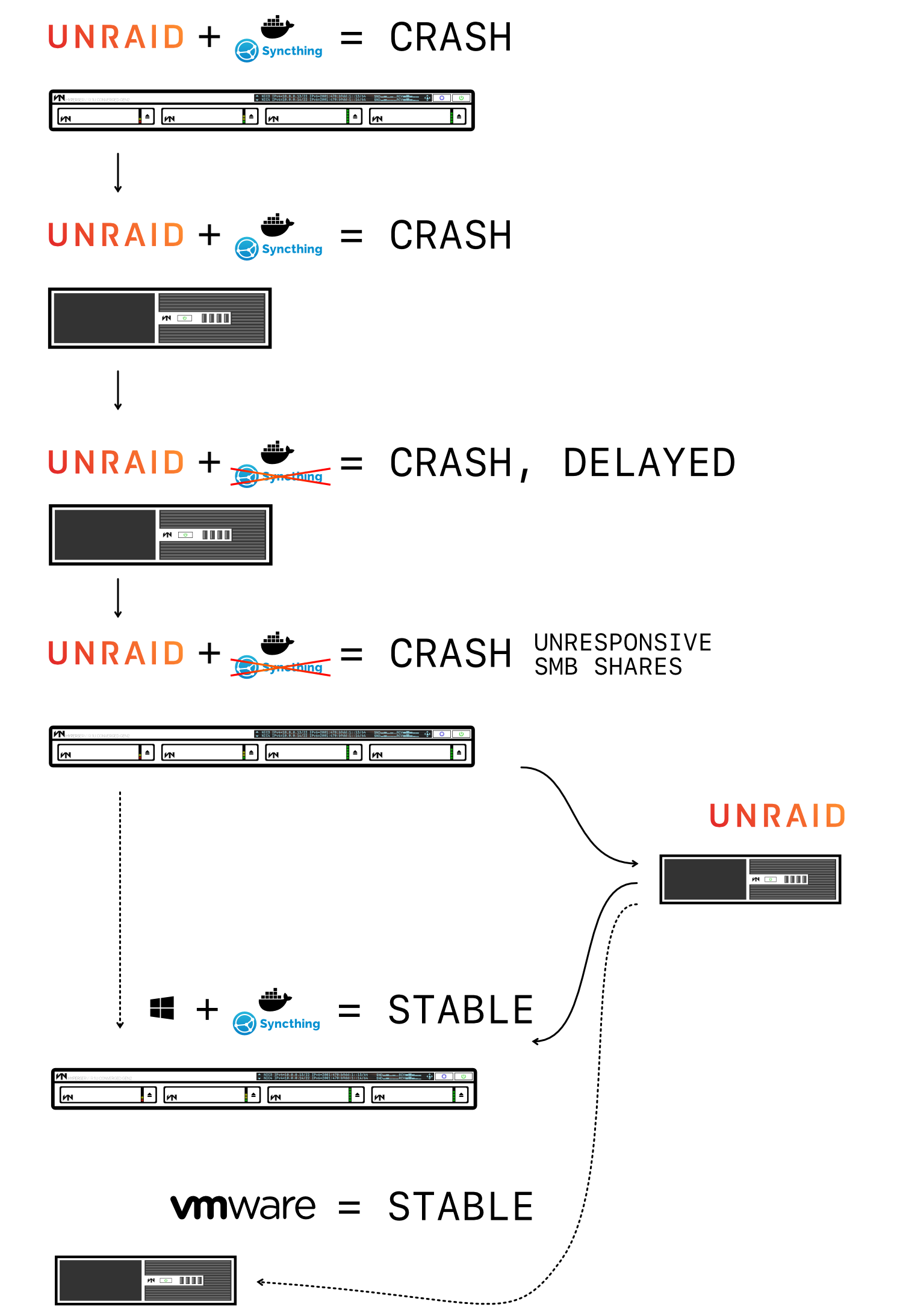

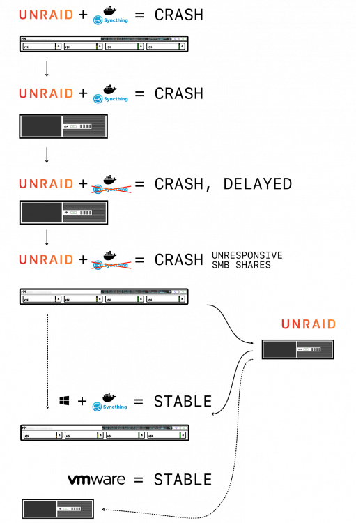

After switching the disks to a new system I was pleasantly surprised indeed it came straight back up, I had to only change the network settings for the LACP bond. I was going to report a few days later everything went OK but the system crashed yet again.
Because of the processor core count going down from 16 (hyperthreaded though) to 4 (real, non-hyperthreaded) it was easier to see the processor was busier I digged a little and found it to be syncthing. I killed the container and rebooted the server and it went without crashes a little further.
It was now very obvious it's not a physical problem so I moved the disks back to the 16-core server with syncthing turned off and it lasted way longer and technically it didn't crash this time but it did stop responding overnight (I play old TV series to help me sleep; hardcore insomniac). I pushed the power button on the server as soon as I sit up (I slept in the server room floor for testing) and it shut down correctly, move the disks on last time to the 4-core and installed Windows Server 2019 on the 16-core server to move the data back to it preserving DHCP/DNS-vs-MAC and rack placement/labeling.
Moved the data at about 2Gbps on spinning disks which was rather impressive because moving the data to unRAID was insanely slow, I assume because of parity but Storage Spaces in Windows Server also does parity calculations and it was ready while I showered and blow-dried my hair.
Once in Windows, I found out that all of the software I used in containers was available for it and I got it all including syncthing and waited it out for crashes and there have been none. I hate Windows but gotta give credit where it's due, Windows is very hard to crash and as long as it doesn't connect to the internet to autof_ck itself up it's a very stable, very resilient OS. Also, if it's not connected, there's no worries about security. That doesn't mean it's not protected, it's domain-joined so all security is automatically applied plus a few tricks to hinder telemetry and Windows Update right from within itself and Active Directory is the one good product Microsoft produces–even if it's a ripoff like the rest of them.
Now for the bad, because I was on the bad server during the trial, I blamed the crashes on the server hardware plus a combination of factors, like power outages that occur every year around August because of the weather and restructuring of the data from different servers while keeping the hypervisors running (from iSCSI) and learning how to use unRAID. On the first days it had way more containers and ran for up to 15 days without crashing too, so that might not be it either.
I think the first logs still apply. I'm leaving unRAID for now to use something stable but since I now have a license I might give it another go in the future. I hope this helps developers or something.
