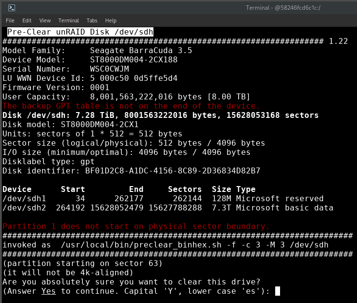

I pulled drive from a brand-new desktop-backup USB HDD and added it to my server (cheap way of getting drives).
/usr/local/bin/preclear_binhex.sh -f -c 3 -M 3 /dev/sdh
After executing the command as per instructions, i see there's 2 partitions, and the boot sector is in 63, not 64.
I don't really know the significance of any of this, is it important? Is the disk OK to be precleared and used in unraid?
I assume it's like this because its probably factory-formatted to windows for use with windows?

See here for more discussion about using sector 63 vs 64:
    https://forums.unraid.net/topic/9333-clearing-confusion-on-af-drives/
In the second post of this thread is a link to a Tutorial which has the command line switch to force a start on sector 64.
     https://forums.unraid.net/topic/83465-support-binhex-preclear/?tab=comments#comment-773206
(I seem to recall that using sector 63 will cause Unraid to assume that the drive has not been precleared...)
Thanks for the reply. The doc states:
    "-C 64 = convert an existing pre-cleared disk to use sector 64 as a starting sector"
So do I run my pre-clear as normal, ignoring the warning (as per prev post's image), then run the -C 64 command when it's finished?
How can I know if the other drives in my system are 63 or 64? They were pre-cleared using the plugin back in 2018.
I believe you use a
-A
as a switch  to 'force' the starting sector to be 64 when you do the preclear . The  -C 64 is an after-the-fact type of thing.   (One issue is that I thought this issue had aged out existence after about 2011.  People just can't recall what all the factors involved were and what they meant...)

Thanks for your help. I'll run the preclear with -A.
IIRC -A is no longer required. It’s now the default.

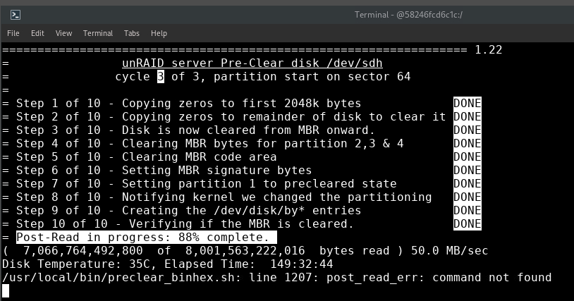

Just coming to the end of my run. This error "post_read_err: command not found" is flashing up on the screen. It is something to be concerned about?  The process seems to be continuing as normal.

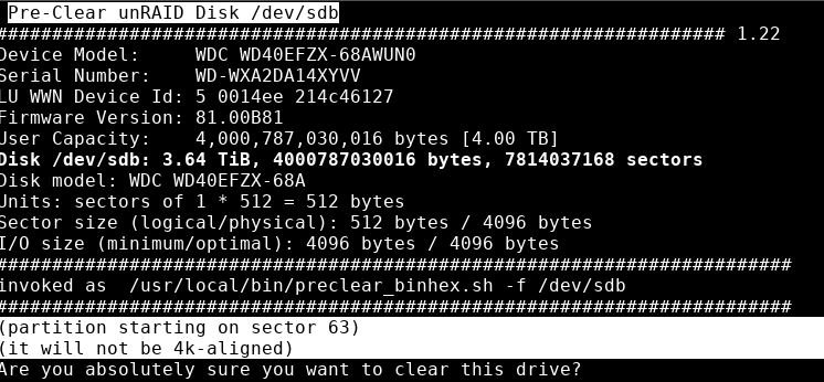

just tried using the script for the first time and  I get the message that partition will start on sector 63.
In the documentation it says that it will start on sector 64 for drives larger >2,2TB.
So shouldn't this be 64 here?
My understanding is the script will automatically fox this for you.
I was wondering, because it does not say it will start on sector 64.
When using the -A option it works of course, but shouldn't this be necessary anymore?
I think -A is the default, so not explicitly required.
I am getting this same error with the same line number... I cant see that anyone had actually responded to this... could someone advise?

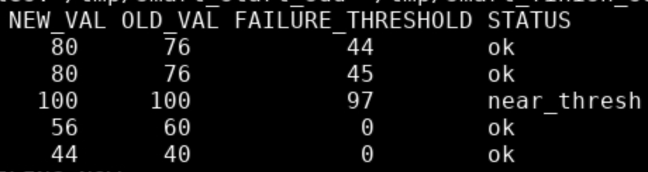

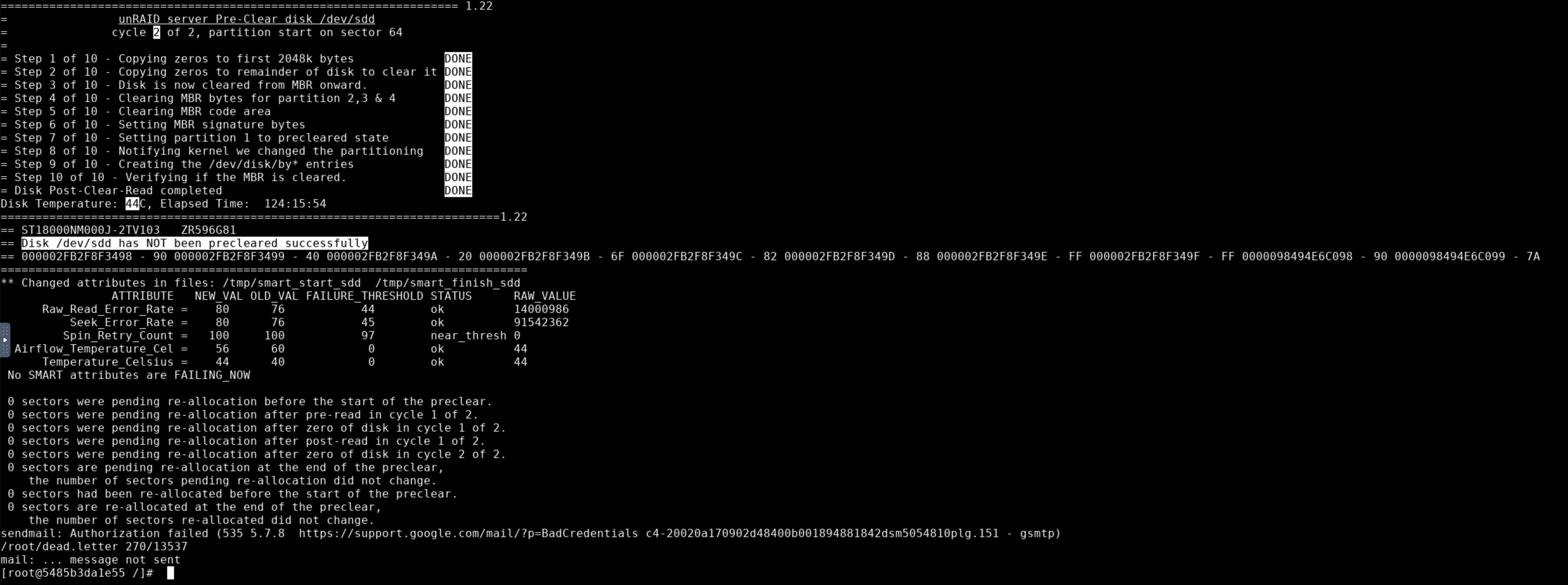

hey all,  this is my first run of Binhex-Preclear. Is someone able to tell me if this drive is good not? I am worries & confused the new/ old value and failure_threshold section, because I don't know how to read it. I have no clue how to setup the emailing a report; is there a guide somewhere ?

Nothing wrong with that drive, looks good to me
