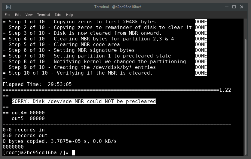

After many years of running preclear - both from the plugin and now the docker, I don't think I've ever seen this one:
That's:
================================================================== 1.22
=                unRAID server Pre-Clear disk /dev/sde
=               cycle 1 of 1, partition start on sector 64
= Disk Pre-Clear-Read completed                                 DONE
= Step 1 of 10 - Copying zeros to first 2048k bytes             DONE
= Step 2 of 10 - Copying zeros to remainder of disk to clear it DONE
= Step 3 of 10 - Disk is now cleared from MBR onward.           DONE
= Step 4 of 10 - Clearing MBR bytes for partition 2,3 & 4       DONE
= Step 5 of 10 - Clearing MBR code area                         DONE
= Step 6 of 10 - Setting MBR signature bytes                    DONE
= Step 7 of 10 - Setting partition 1 to precleared state        DONE
= Step 8 of 10 - Notifying kernel we changed the partitioning   DONE
= Step 9 of 10 - Creating the /dev/disk/by* entries             DONE
= Step 10 of 10 - Verifying if the MBR is cleared.              DONE
Elapsed Time:  29:53:05
========================================================================1.22
== SORRY: Disk /dev/sde MBR could NOT be precleared
== out4= 00000
== out5= 00000
0+0 records in
0+0 records out
0 bytes copied, 3.7875e-05 s, 0.0 kB/s
0000000
[root@a2bc95cd16ba /]#
Don't know that I've ever had an MBR related error before.
Additionally, it was throwing a ton of errors while clearing (as viewed from UD):
and now that I've got the preclear error, I'm seeing this on the disk details in UD:
Plus, I've got a nasty squeaking sound coming from the server that's never been there before.
This drive had right at zero power on hours when I installed it and first checked the attributes (forgot to do that immediately, but the POH was roughly equal to the run time of the preclear at that time, so it was pretty close to zero).
Is this likely:
A) bad SATA cabling/poor seating in the hot-swap bay?
B) DOA hard drive?
Is there any chance that popping it out of the hot-swap bay and plugging it back in might help?
I'd provide the full log file(s), but the most recent logs in ...\appdata\binhex-preclear\preclear_reports are from 2022 - nothing from this drive's run. If they're held temporarily elsewhere, point me at 'em and I'll upload here.
