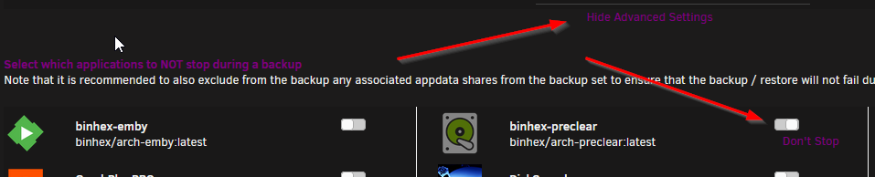

hrm... this isn't a good sign. Container uptime 9 hours. Server uptime 2 days, 15 hours 43 minutes.
The container shut down at 02:47 this morning. Here's the last line in the log from the start up on 9/21, followed by the shutdown early am on 9/22 and the startup 1 hour later on 9/22.
Never mind...
Appdata Backup
When a Backup is running (either manually or a scheduled backup), your docker applications will be stopped and then restarted at the conclusion of the backup
Because:
Disables CA Backup. Makes calendar entry to re-enable it when preclear is finished.
Makes additional note to re-read Note in FAQ Answer #7.  It may do well to highlight that note - it took both of us 2 days to realize what was causing the issue, so it's likely others will miss it as well.
Actually - a better option exists in the CA Backup config:
Leave backups enabled, just don't allow it to stop binhex-preclear. I don't know if there would be any open files in the docker that may not get backed up, but considering that there aren't really any options to set (defaults work just fine for me!) and even if you do customize ports or something else, you'll probably have multiple backups made before and after running an individual preclear, this seems reasonable.
Edited by FreeMan
Never mind...
Appdata Backup When a Backup is running (either manually or a scheduled backup), your docker applications will be stopped and then restarted at the conclusion of the backup
Because: image.png.61493ffed2f0594947ce363bedc51821.png
Where is this? I don’t see anything in CA Backup/Restore that resembles your screenshots at all.
Advanced settings
Sent from my NSA monitored device
52 minutes ago, Squid said:
Advanced settings
Thanks. The purple text is really hard to see in the dark template and I was trying to find it in the top right corner. Totally missed it the first dozen times. 🙂
Thanks. The purple text is really hard to see in the dark template and I was trying to find it in the top right corner. Totally missed it the first dozen times. [emoji846]
Submit a report on the thread I will forget all about that
Well, there was a big arrow pointing at the text, but I suppose when it was totally out of context, it's hard to figure out where that was actually pointing. Especially since the list of dockers doesn't appear until after you click the "advanced" link.

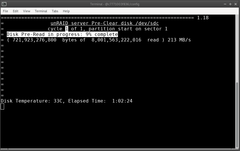

1387202161_2019-09-2408_52_24-Preclear-noVNC.png.cdd89ecb38180bd898e97a6196ab5a02.png
too late...
Ok no worries [emoji16]
Sent from my CLT-L09 using Tapatalk

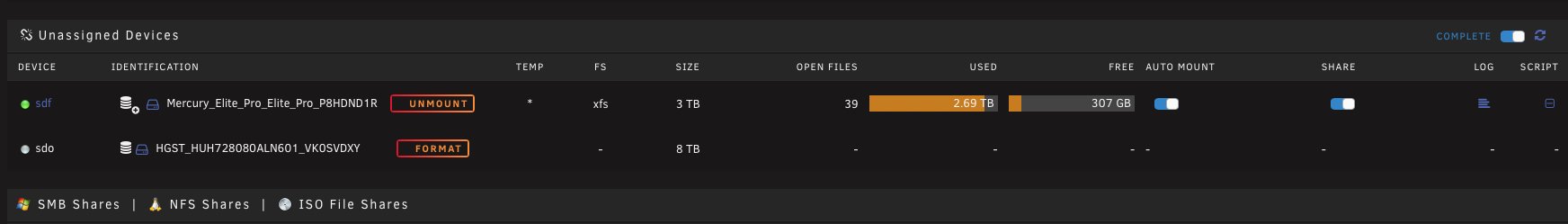

Can't get this to work.
Sorry: /dev/sdo does not exist as a block device
Clearing will NOT be performed
[root@bef0414753a7 /]#
/dev/sdo is seen as an unassigned disk.
I tried formatting and mounted/unmounted. Same error every time. The drive is installed in the server, not external. Any ideas?

Try restarting the container
worked thanks

== with a starting sector of 1
== Ran 1 cycle
== Using :Read block size = 1000448 Bytes
== Last Cycle's Pre Read Time  : 14:00:01 (158 MB/s)
== Last Cycle's Zeroing time   : 12:18:43 (180 MB/s)
== Last Cycle's Post Read Time : 14:17:20 (155 MB/s)
== Last Cycle's Total Time     : 40:37:03
== Total Elapsed Time 40:37:03
== Disk Start Temperature: 31C
== Current Disk Temperature: 32C,
** Changed attributes in files: /tmp/smart_start_sdc  /tmp/smart_finish_sdc
                ATTRIBUTE   NEW_VAL OLD_VAL FAILURE_THRESHOLD STATUS      RAW_VALUE
      Raw_Read_Error_Rate =    83      82           44        ok          217697608
          Seek_Error_Rate =    77      76           45        ok          55541351
         Spin_Retry_Count =   100     100           97        near_thresh 0
         End-to-End_Error =   100     100           99        near_thresh 0
  Airflow_Temperature_Cel =    68      69           40        ok          32
       G-Sense_Error_Rate =    99     100            0        ok          2432
      Temperature_Celsius =    32      31            0        ok          32
   Hardware_ECC_Recovered =    83      82            0        ok          217697608
 No SMART attributes are FAILING_NOW
 0 sectors were pending re-allocation before the start of the preclear.
 0 sectors were pending re-allocation after pre-read in cycle 1 of 1.
 0 sectors were pending re-allocation after zero of disk in cycle 1 of 1.
 0 sectors are pending re-allocation at the end of the preclear,
    the number of sectors pending re-allocation did not change.
 0 sectors had been re-allocated before the start of the preclear.
 0 sectors are re-allocated at the end of the preclear,
    the number of sectors re-allocated did not change.
Also:
parted -l
Model: ATA ST8000NM0055-1RM (scsi)
Disk /dev/sdc: 8002GB
Sector size (logical/physical): 512B/4096B
Partition Table: msdos
Disk Flags:
Number  Start  End  Size  Type  File system  Flags
So it does recognize that it's an 8TB drive. The partition table of "msdos" is a little disconcerting, the others are showing gpt. The others also show partitions under the table listing at the bottom and a file system of "xfs". I would presume at this point that these differences are due to the fact that the disk hasn't been formatted yet.
Any thoughts, comments or concerns, or should I just shove it in the array now with a variety of lessons learned?
