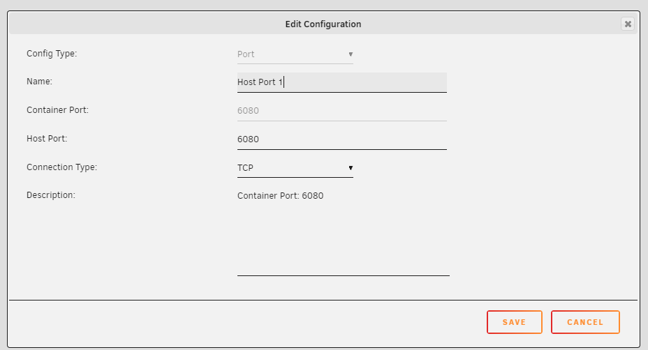

Interesting observation.  I have both Binhex_Preclear and Binhex_Krusader installed.  If either one is 'Started', the other one will error out when you attempt to start it with this message:
'Stopping' the first one will allow the other one to start.  Apparently, you can not have two running instances of noVNC running at the same time.
Yes you can check host port
I assume this is a setting somewhere.  I did some looking on my own and found this:
Is this where I would make this change?  Would changing the 'Host Port' to (say) 6081 work? Or am I completely off base?
Yes that would do it
