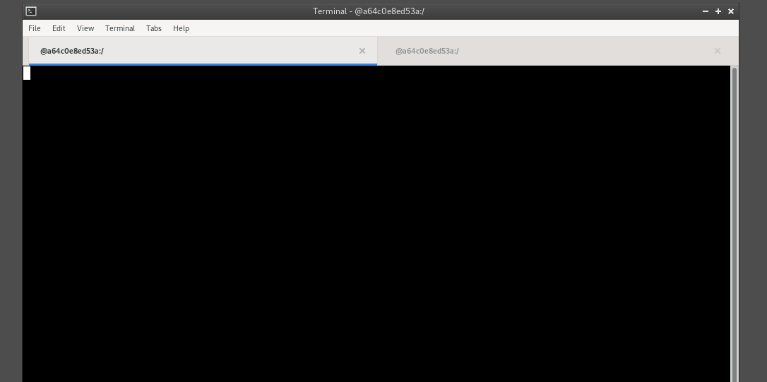

From the binhex-Preclear FAQ:
Q5. Can i preclear multiple disks at the same time?.

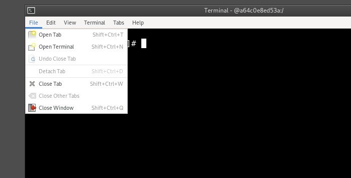

A5. Yes this is possible, you simply create an additional 'tab' in the 'Xfce terminal' and then run the script again against the additional named drive.
This should be enough information for the experienced Linux user but it leaves much to be desired for the many folks who do not fit this description.  I will attempt in a brief manner to fill in  the gaps.  First, start the binhex-Preclear WebUI.   Now click on File in the Terminal Toolbar and you see get the following:
Now click on the 'Open Tab' in the drop-down list:
Notice that we now see two tabs directly beneath the Toolbar.  These are two independent terminal sessions.  We can switch between the sessions by clicking on the tabs.  We will be running a preclear session in each tab on different hard drive.  We can use the instructions in this Tutorial to set up each session:
     https://forums.unraid.net/topic/83465-support-binhex-preclear/page/4/?tab=comments#comment-789518

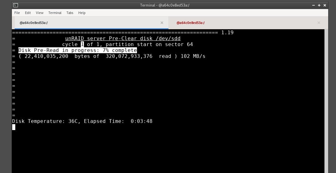

This is one session running:

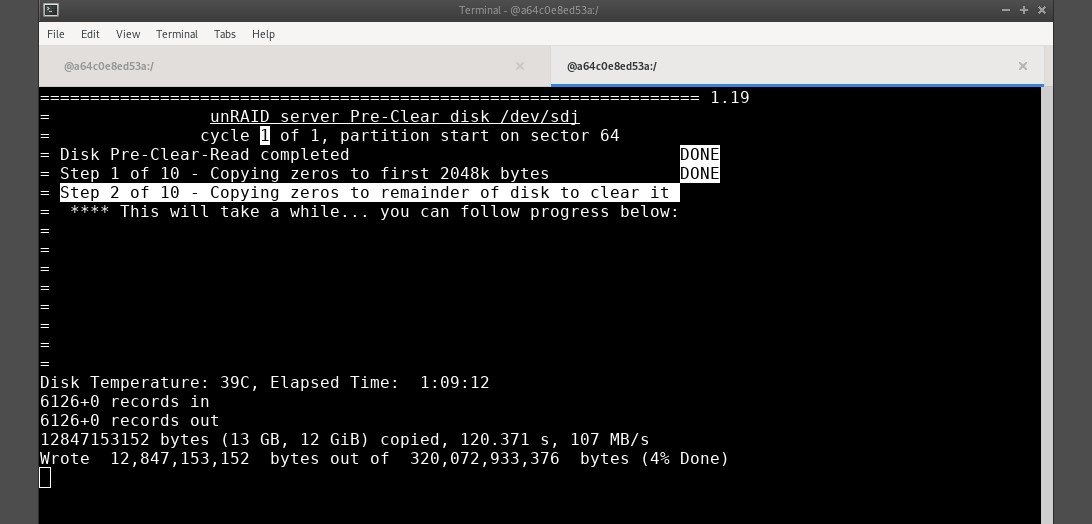

And here is the second one:
Both sessions will send out e-mail notices (You can separate the e-mails by the device designation-- /dev/sdX) and multiple preclear sessions run at approximately the same speed as a single session would.  You can run more than two sessions (each one is a separate tab) but I am not sure what the upper limit on terminals/tabs that you can open.  (I have opened 6 sessions/tabs but I don't have that many drives available for testing!)   However, each session will require a certain fixed amount of memory to run in and this could become a problem.
