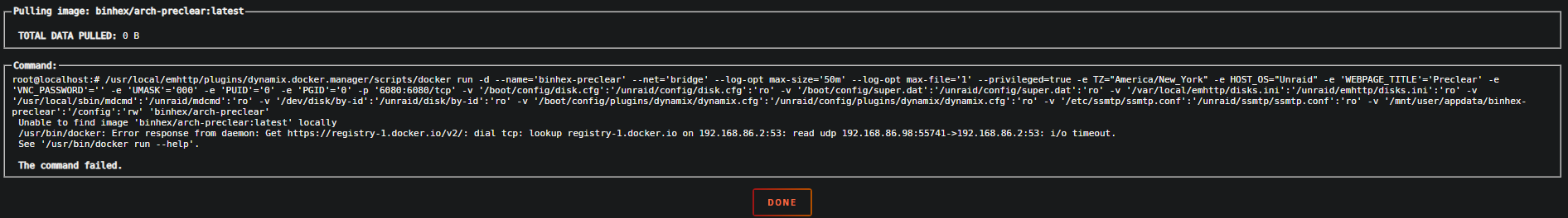

I tried to install this from the APP store (binhex-preclear) but I got this error while running the docker run command:
You have DNS issues with unraid, it cannot resolve docker hub.
