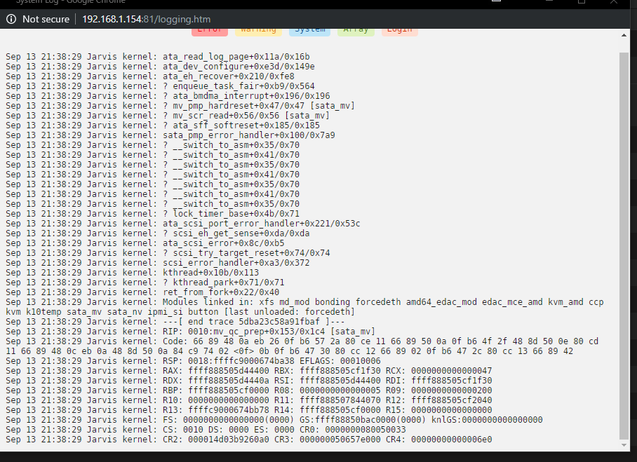

my server starts up fine on version 6.7.2 but when i plug in an ssd to set up as a cache drive the UI freezes and I get messages in the log. Any suggestions?

Are you 'Hot-plugging' this drive?  What happens if you connect it up when the server is powered down and then start the server up?
If you're connecting the SSD to a SAT2-MV8 controller they are known to have issues with recent devices, be it HDD or SSD, try using the onboard SATA ports instead.
this solved my problem, thanks!
