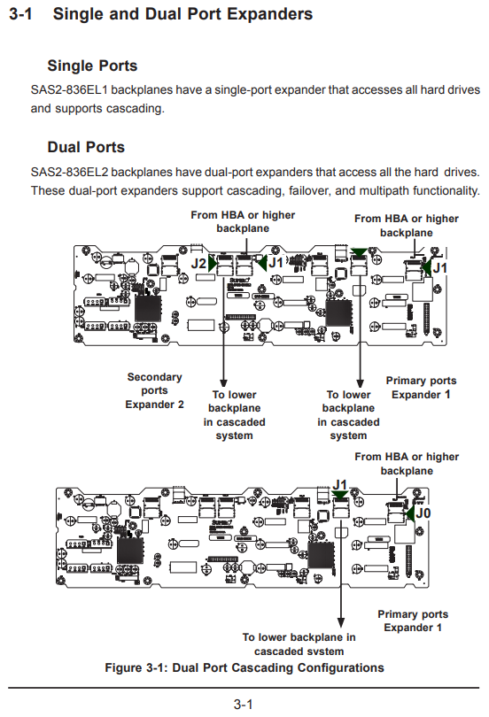

I have to admit I find the BPN-SAS2-836EL Backplane guidance pretty confusing with regard to cabling. Maybe part of the problem is that manual covers both BPN-SAS2-836EL1  and EL2 backplanes.
The only scenario in the manual where I see discussion of using the second of the 3 primary SAS connectors on the BPN-SAS2-836EL1 backplane is when connecting to a 'lower backplane in cascaded a system' (see below pic) but I may well be missing something.

I'm curious what PRI_J3 would typically be used for?
Extra port is for cascade, usually you can use any port(s), it should auto detect if it's connect to a HBA or another expander, similar to a switch.
