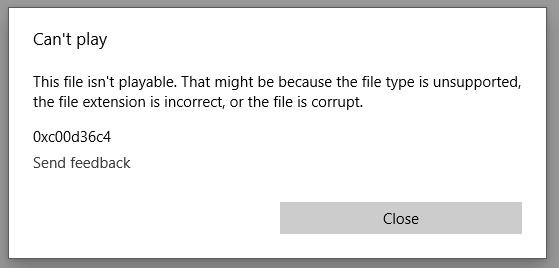

Now that I'm testing data on the UNRAID Server I'm seeing a ton of problems. See attached photos.
Does not matter the format of the file they do not open and show as corrupt.

yes. The files come from many sources and are being archived on the UNRAID server. Strangely. If I copy "OVERWRITE" over a directory that is not working with the same directory data, the files still fail. But, if I copied the data into another new directory, they work file... I'm lost.
Sounds like it could be an issue with specific drive(s). Are you using shares that are spread across all your drives?
Yes. I them set to fill 50% and move onto the next and so on.
Try testing the files drive by drive and see if there is a pattern to which ones work and which ones don't.
Is there a command / way of show wish drive a specific folder / directory is housed?
If you click on the folder icon at the end of a line on the shares tab then you will be shown where folders and/or files are located.
 Thank you itimpi.. I will check it out now to see if it is only one drive or something random across multiple
