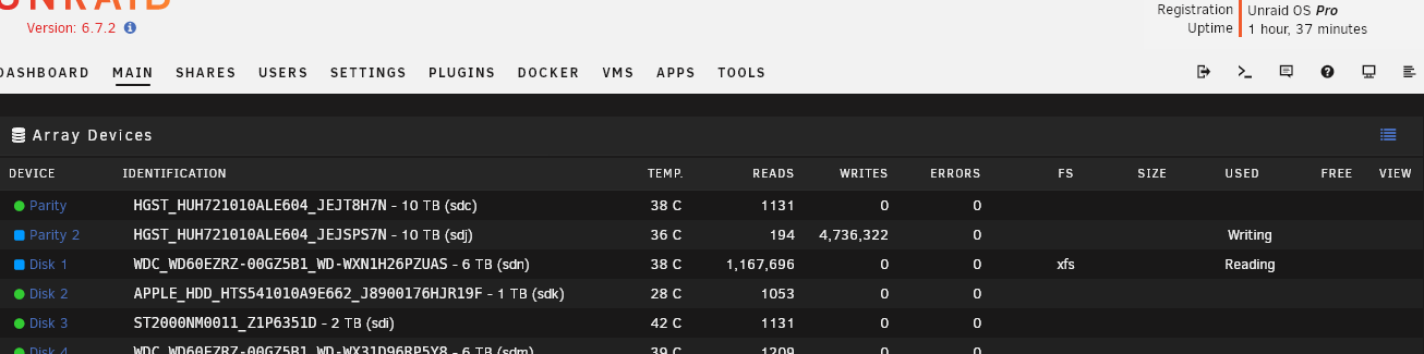

September 21, 20197 yr Author 7 hours ago, itimpi said: There is something wrong with your description It is not technically possible to have a 10TB drive in the array if one of your parity drives is only 6TB. It is a requirement that ALL parity drives must be at least as large as the largest data drive. I had just added that 10TB to unraid, it wasn't used by the array yet (although it was in the dropdown to select with a stopped array), so yes, my description was incorrect if that's what it said. Either way, 'swapping' disks in one go works, it is now copying the parity from old parity 2 to new parity 10TB, and said it will then recreate the ex-parity disk as the (new) disk1 for the array (FYI, disk 1 wasn't the 10TB before, it was another disk that needed to be replaced); Edited September 21, 20197 yr by Julius
