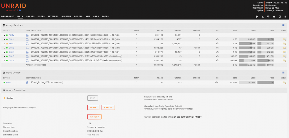

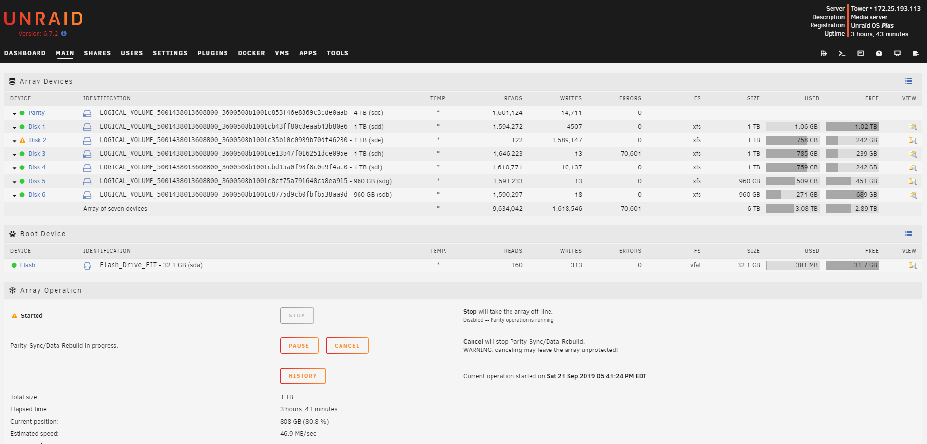

Can't be.  Formatted or not, it's a member of the array.  Post a screenshot of your Main Tab and your Shares Tab

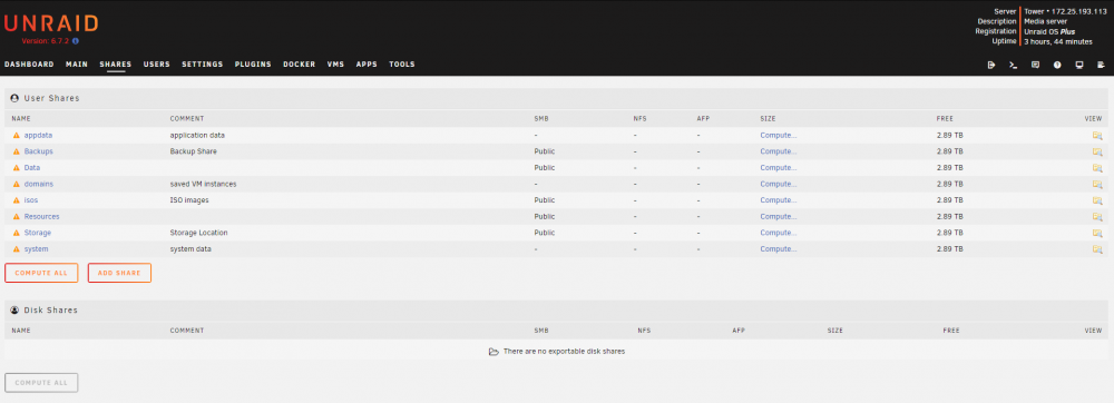

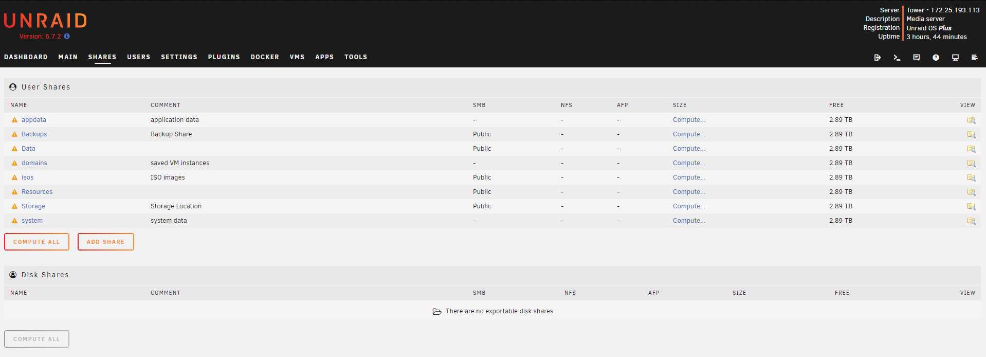

When I UNC to the server, The storage share is empty along with several others.....

You've got filesystem corruption on disk 5 (this is why you're not seeing the shares)

Updated Diagnostics post Disk 2 rebuild. Shares have returned to normal. No data in my storage share still. Going into maintenance to run filesystem checks
