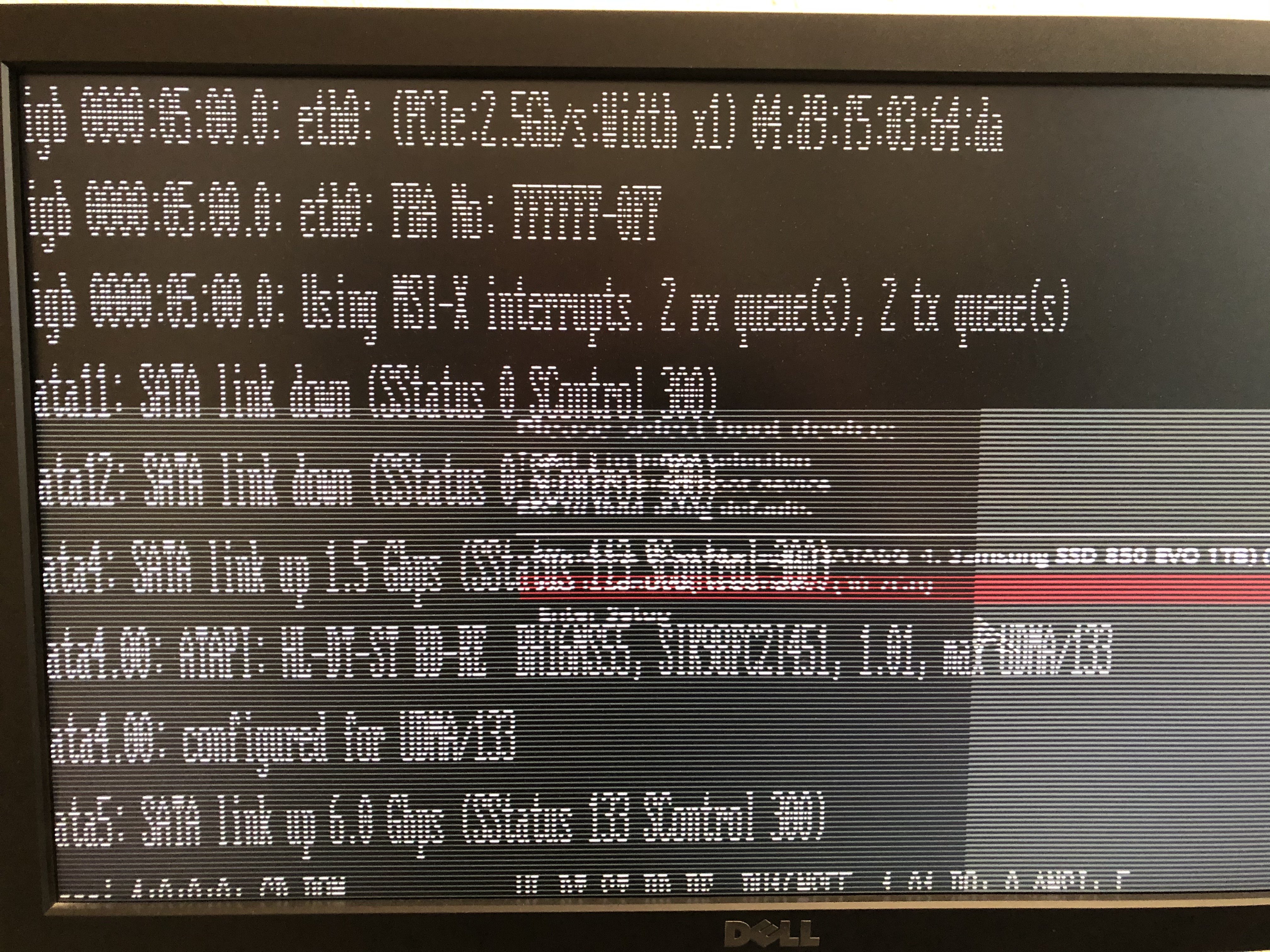

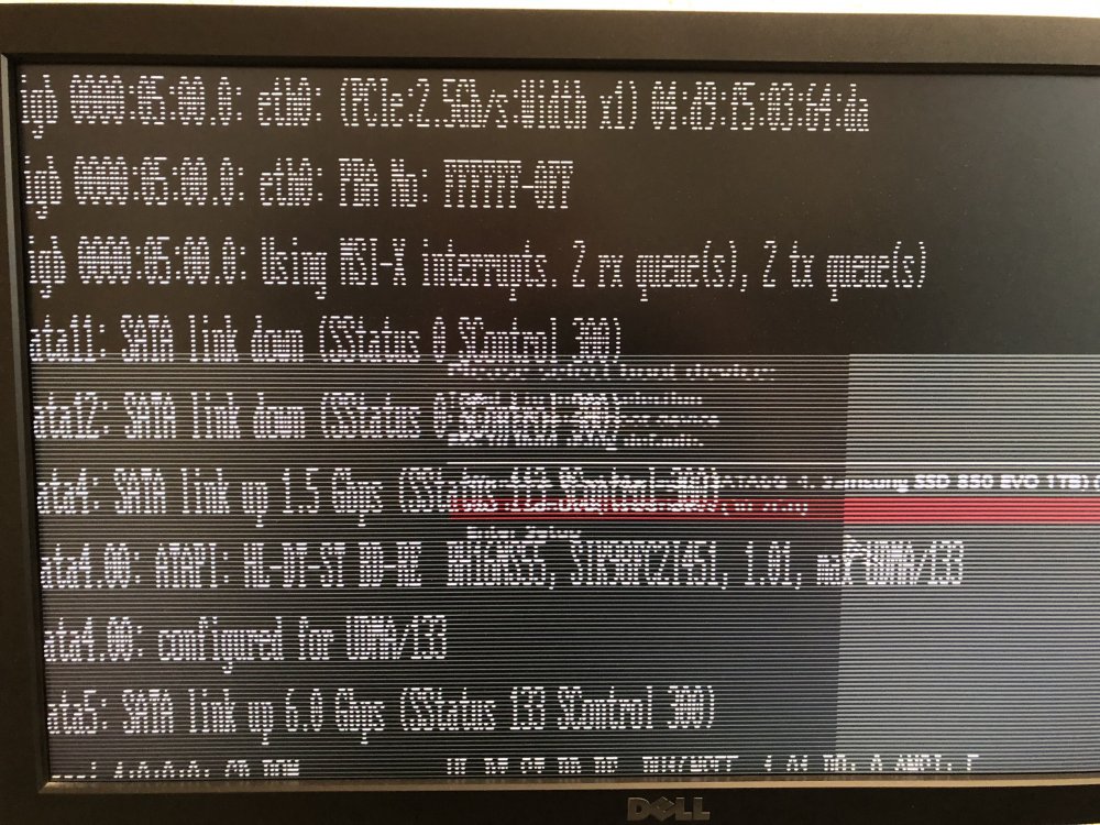

Update: After giving up yesterday, I used the original Windows KVM which is bootable like a baremetal system. I installed the newest Nvidia graphics driver and played some games without any issues.
Today I created a new Windows VM in unRAID with the same hardware specifications like the first one and there I just got an ugly image on the screen and nothing else (see below). But at least unRAID seems not to crash... Yesterday at first the "VM tab" in the Web GUI was not reachable and then the whole system crashes.
Has someone any ideas? Couldn't find something yet in the web.

Update 3: Thats the error message which I get:
2019-09-23T15:29:53.780080Z qemu-system-x86_64: vfio_region_write(0000:09:00.0:region1+0x2206c8, 0x0,8) failed: Device or resource busy
