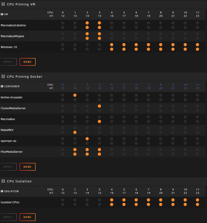

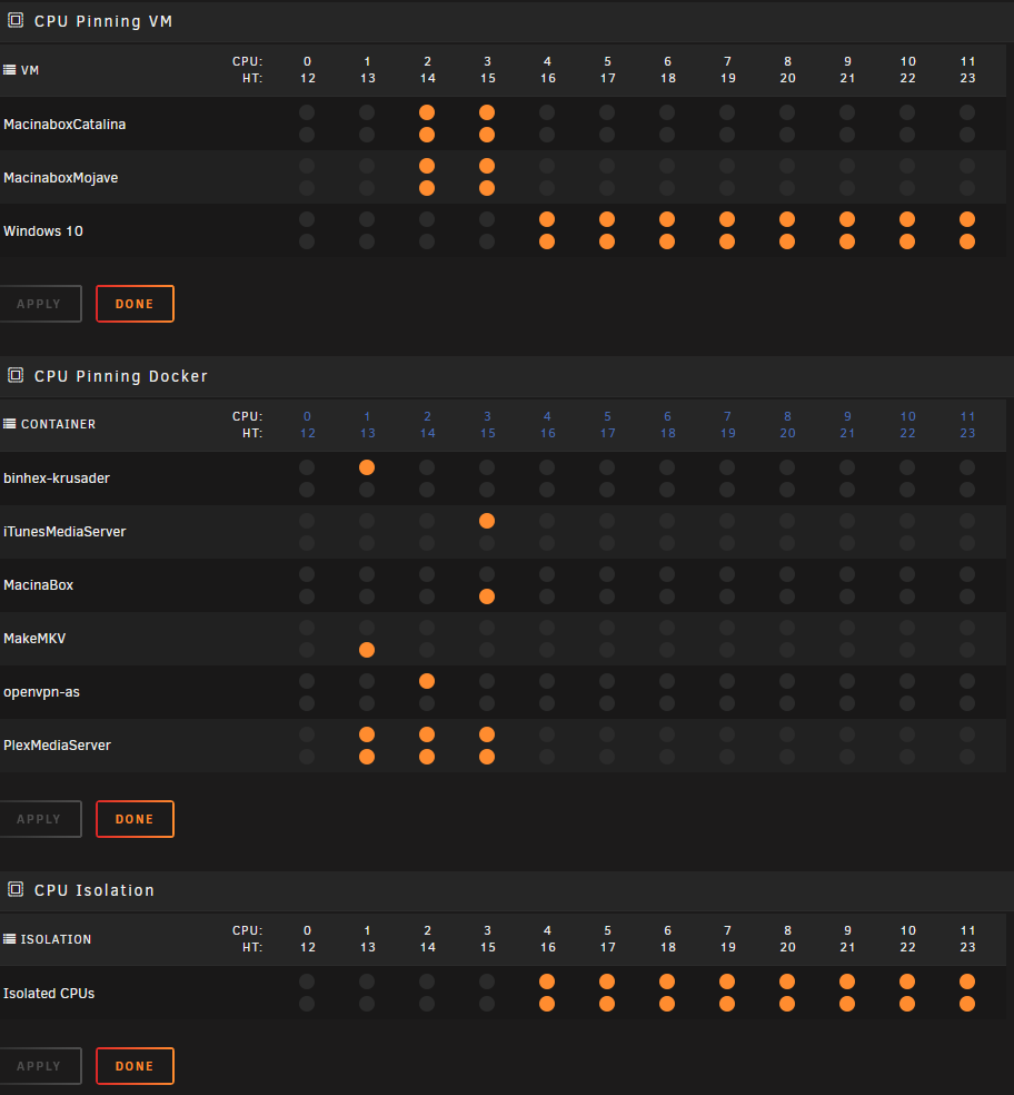

@metathiasOk, I updated the CPU Pinning, see the screenshot. Now nothing "blocks" Core 0 and his HT twin.CPU_Pinning.thumb.png.213021521270cf02425076e53f3c935a.png

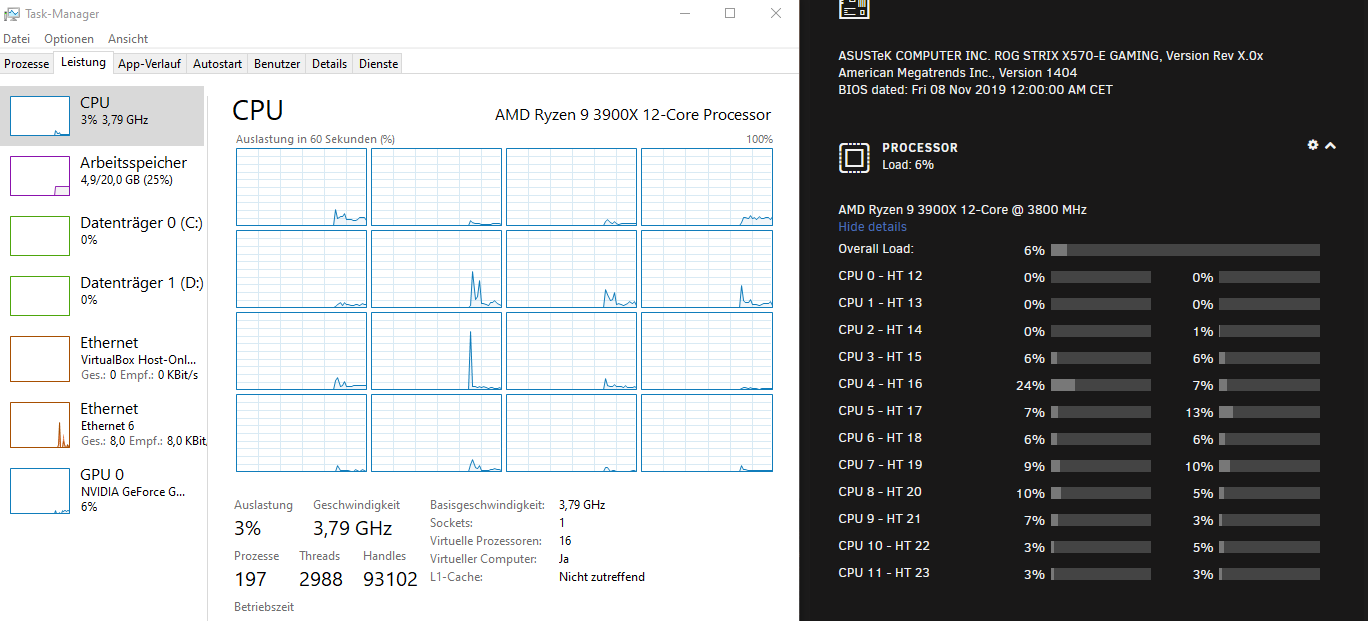

But the Overhead is still there. As you can see:
I also tested it with just 6 cores. My idea was because of the Ryzen 3900X which is actually 2 x 6 cores on two dies, maybe thats has an impact. But it doesn't matter, with just 6 cores/ 12 threads the overhead is also present.
After the restarts of the VM I also recognized that the impact of the overhead seems to be variable, because after the restart and testing in a game, the lag was not noticeable but the overhead was still there..

@cap089 What do you mean by "overhead"?
Is this not the right term to describe this? The core utilization is higher than the Windows VM actually need. I know the refresh intervall of the task manager and the CPU load overview in unRAIDs WebUI is not perfectly syncronized but a difference up to 30% seems quite high and it get noticeable in games.
Honestly i have never thought to compare the two. Not sure what good it would do. Resource utilization meters. On both Unraid, And Task manager in the VM. Essentially just take a snapshot of the CPU current usage at the exact moment in time it was captured. It practically impossible to make sure they took a sample at the exact same moment in time. Therefore it highly unlikely their going to agree from one interval to the next about exactly how much that thread got utilized since the last interval.
Hmm. But when I check the graphs in the WebUI over time, I have constantly load on the first core from about 20% and on the second about 15%. And 3-5% on the other threads. And this during Windows is in idle - just chatting or watching Netflix.
And of course when the VM is shutdown or in sleep mode the load is gone, so its connected to the VM and nothing else..
Perfectly normal for me. First core of my VM shows about the same with nothing running (15-20%). Again i would ignore this metric. Focus on real world benchmarks. And gameplay.
