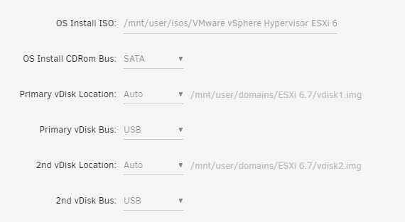

I'm able to get ESXi to boot, but when it comes to installation it is asking for the disk location to continue the installation.
As seen in the screenshot, it isn't locating any media to perform the install on.
Is there something I'm missing in order to get his up and running? Thanks!
Did you create the primary vdisk and make it USB?
When I did my install I had the iso of the installer and an 8GB drive created and mounted as USB. Then I created a 100GB img on my cache drives to use as the array.

Thanks! So it turns out I did not follow the instructions as I assumed I had.  This fixed it for me.
My only issue now seems to be that I cannot see/create data stores.  I created a second drive in the VM options (also USB) and it doesn't even detect it.  Would you happen to know how to create a data store in order to place the VM's? You mentioned you created a 100GB img, was this within the VM edit options? This is what I have done,
Edited by xeven
It should be sata I think... Not USB. I don't think USB is an option for the array.

Yeah I tried SATA as well and still didn't seem to pick it up. Was there anything else you needed to do in the XML?
Nevermind, it seems to be working now.  Although my main issue now seems to be that the ESXi controller says I don't have VT-x enabled, which wouldn't make sense as it's a KVM which needs VT-x???

Ok so I figured out the VT-x issue.  The scripts that I was supposed to run did not run properly, but now it's working.
