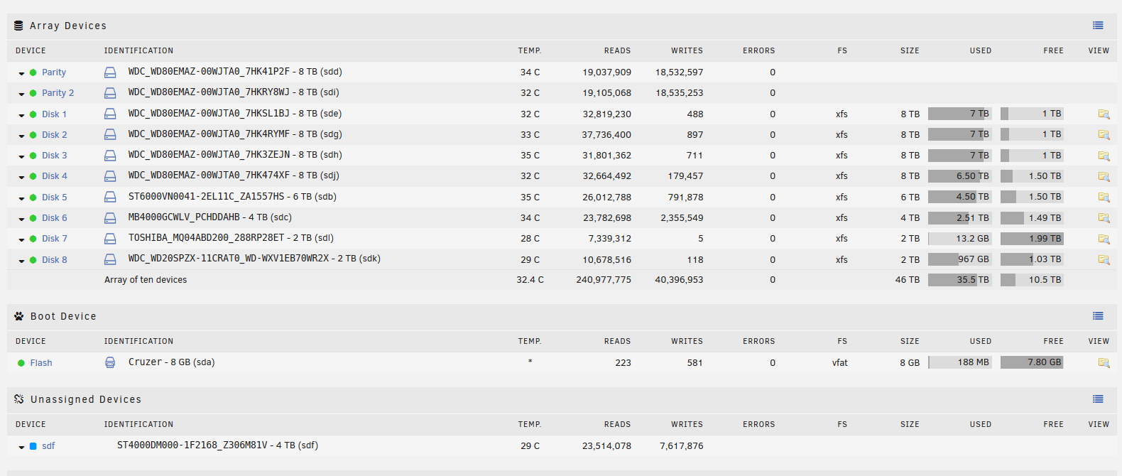

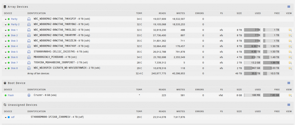

I have it set to place files on the drive with the most free space, so I'm not sure why it's not putting files on disk7. I did copy the 13.2GB of files that are on this disk using the command line from a disk that was having issues before removing the disk that had issues - perhaps that's got something to do with it? Not sure.
Thanks in advance for any assistance.
