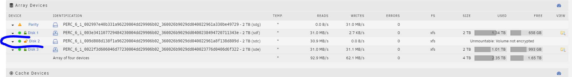

I'm stuck on retry unmounting disk shares. I dont have any folders open , no cli, VM's are off. dockers are off. What am I missing?
I rebooted server and that was solved.
I just need to figure out why disk2 isnt encrypting.
You probably also need to run a file system check on disk1 by clicking on it on the Main tab and selecting that option.   It has not mounted so presumably has file system level corruption, but you have not provided the system diagnostics so it is not possible to be sure of that.
