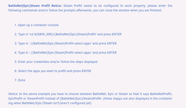

Hey ich777,
first of all: thank you for all those docker templates you provide. Really appreciate them!!
Recently I have been working with the LANCache-Prefill template and noticed that for BattleNet and Epic the Parameters are missing (SteamPrefill Parameters are present).
Added the BattleNet one manually now for myself. Will these be added in the future? Is there a way to create some kind of pull request so that I could provide them?
Kind regards
Dustin
You don't need parameters for BattleNet and EpicPrefill anymore, you have to just configure them as for your Steam account and my container will then execute the prefill.
This changed a few months back and is also described here how to configure:

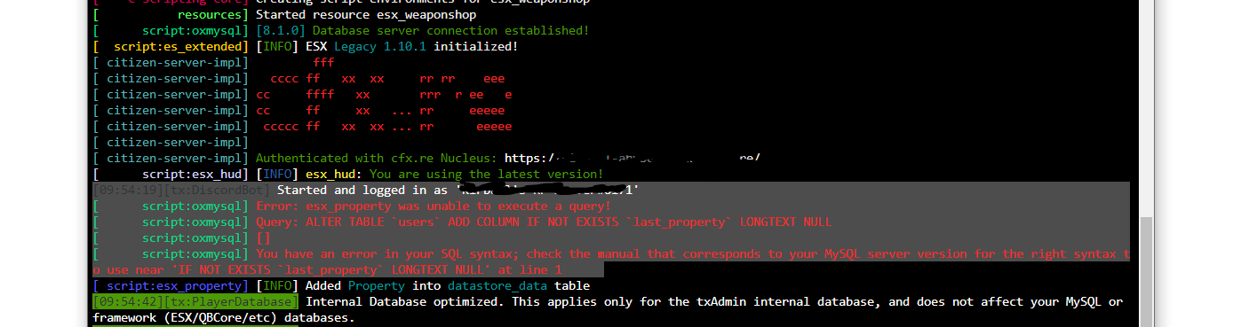

Has anyone been using TxAdmin with their fivem server?  Is there a way to have it start on it's on and not keep turning off?  Seems like everytime I check the server is down and I have to run the startup script.
I am also getting this error when starting my txadmin image.thumb.png.61406d59aebf0e42616e84968af6ac43.png
Wrong support thread.
It seems that your database is corrupt or at least something is not working properly. I would recommend that you ask about that on the FiveM forums.
It won't turn off on it's own usually, maybe this is related to your database error from above.
There is a seperate thread for fivem?  That would explain why I couldn't find anything about it here.
The gameserver thread, click on the Container icon and Support. Anyways, this is not a separated thread for FiveM and this seems to be an issue with your installation, as said above, I would strongly recommend that you post that error on the FiveM forums.
txadmin is also running just fine and should not end itself automatically, this is the first time I hear that someone has such an issue.
