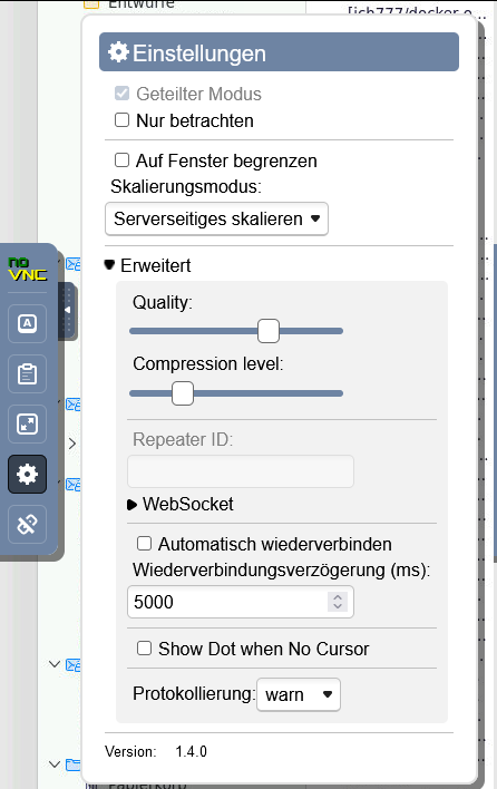

    System Location: We're running this in the cloud, not on a home system.
Are you sure that the connection is sufficient?
Maybe try to tweak the quality and compression sliders, the quality slider will affect the bandwidth and the compressions slider will affect CPU utilization:

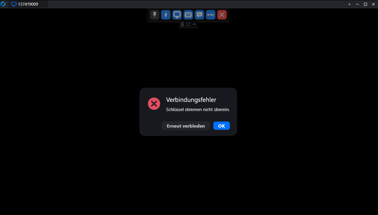

39 minutes ago, ArthurM said:
I've removed and reinstalled the container and I'm still able to join by only providing my domain name...
Please check if your have stored a key/config on your local PC:
You can connect to your server with no key but you actually can't connect to any client because the keys don't match or is non existent in this example on the client (this screenshot basically says that the keys doesn't match) :
Even if I connect two clients to my server without any keys they can't connect.

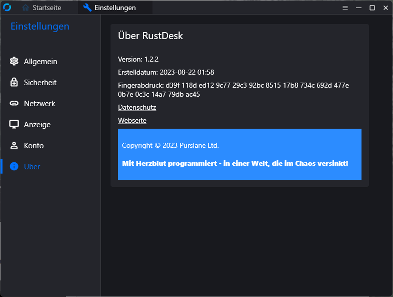

Yes:

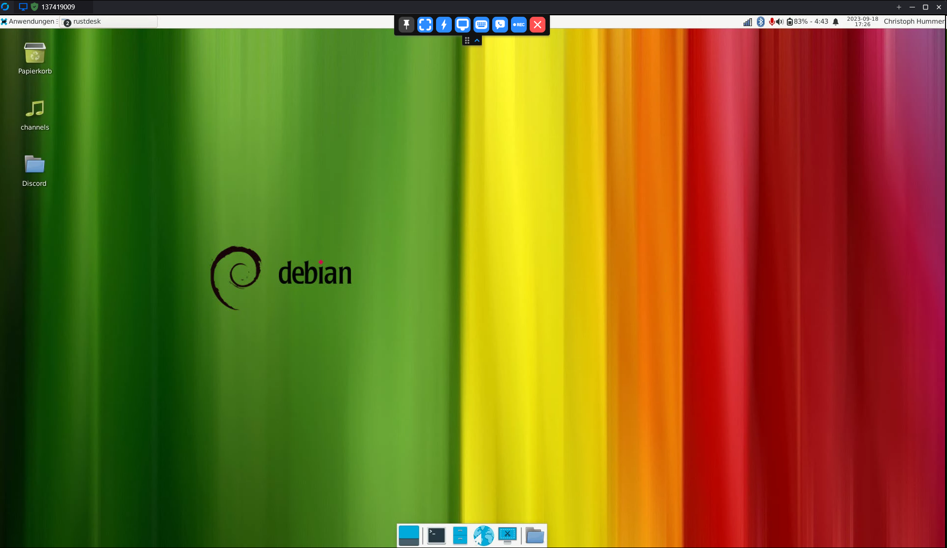

(this is a screenshot without my key/config in appdata)
Here is also a screenshot when I connect to my Debian Notebook from my local Windows PC when the key from both clients match my servers key:

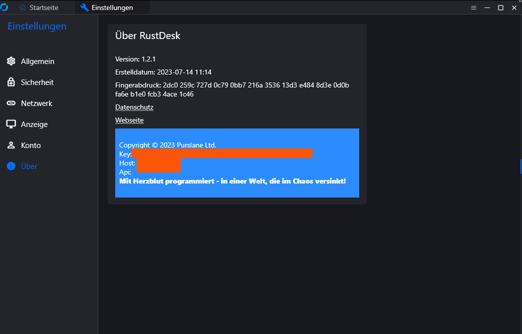

Here is also a screenshot where you can see that I have a key in my appdata:

Yes:
(I'm one version behind on this PC, but this makes no difference)
Fantastic, sorry I didnt realise that the key was checked when clients are attempting to connect. It is indeed working as intended! The "green" ready really got me confused :)
Hoping they figure out the mac builds on github soon!

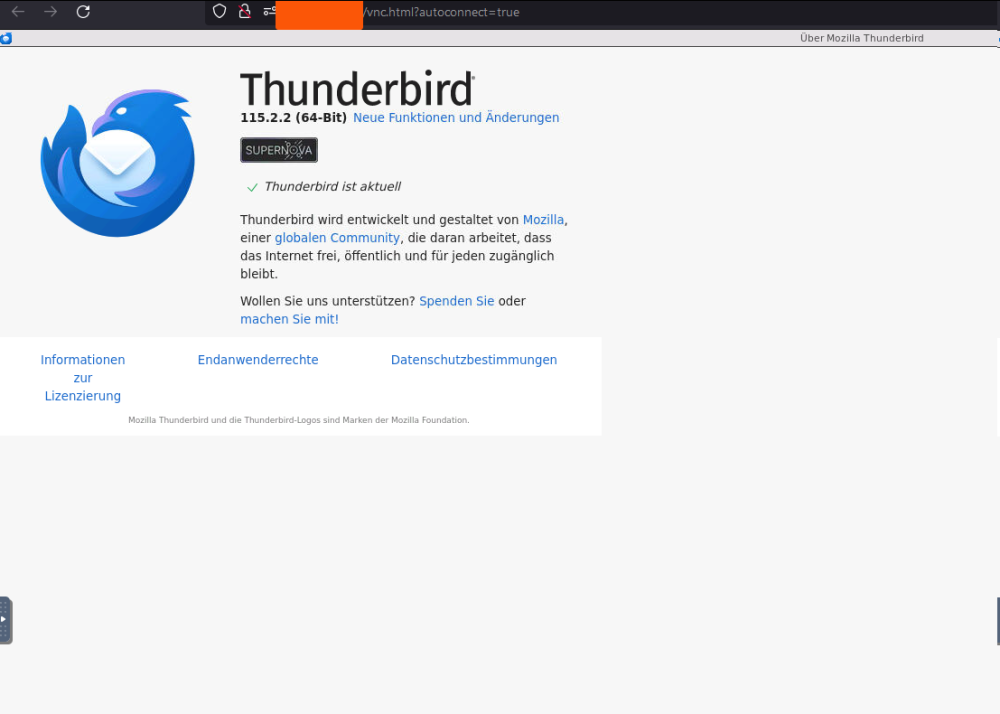

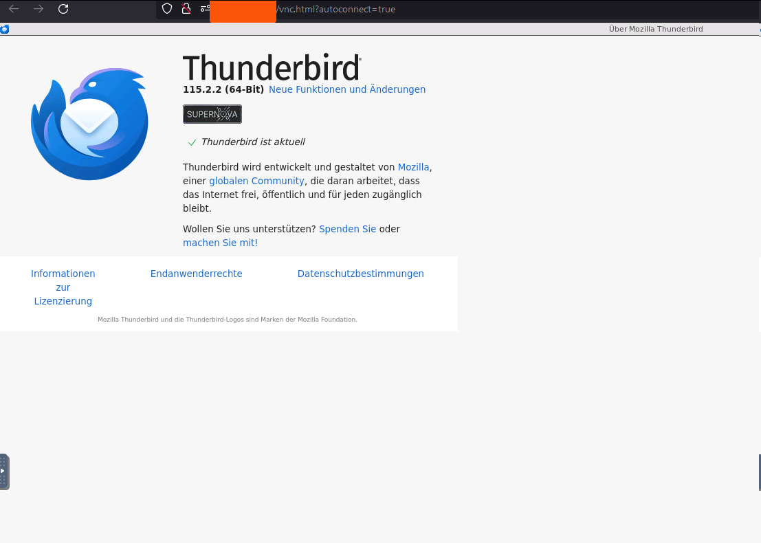

Since thunderbird supernova launch i wasn't able to update thunderbird to the newest version and got it running.
Thunderbird always did reset to version 102. When i manually updated it i always had to go over 105 and last to 115.
After the next restart of my docker, it was set back to 102 and wasnt working anymore, because the profile was updated to work with 115.
I now deleted my container and backuped the files to redownload your latest version and create the containter from anew. but now i always geht the error screen see in the screenshot, also i added the log file from my container in the html file.
Hope it helps to find the bug.

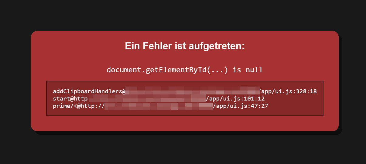

If you have reported that early I could have fixed that since the container simply wasn't ready and now it is, another user reported that and I fixed that almost imideatley.
This was fixed a few weeks ago, you can now either select if you want to download the stable or beta version from Thunderbird:
This is not a bug, simply clear your browser cache.
Please make also sure that you are on the latest version from the Docker container itself.
EDIT: I'm running my Thunderbird container as my main Mail client with about 20k Mails spread across 5 Mailboxes in it and everything is working fine over here (even the upgrade from the older version to the new went without a hitch) :
Please report if you have an issue immediately otherwise I or any other maintainer can't fix them (...and this will save you also a lot of trouble from what I read above).

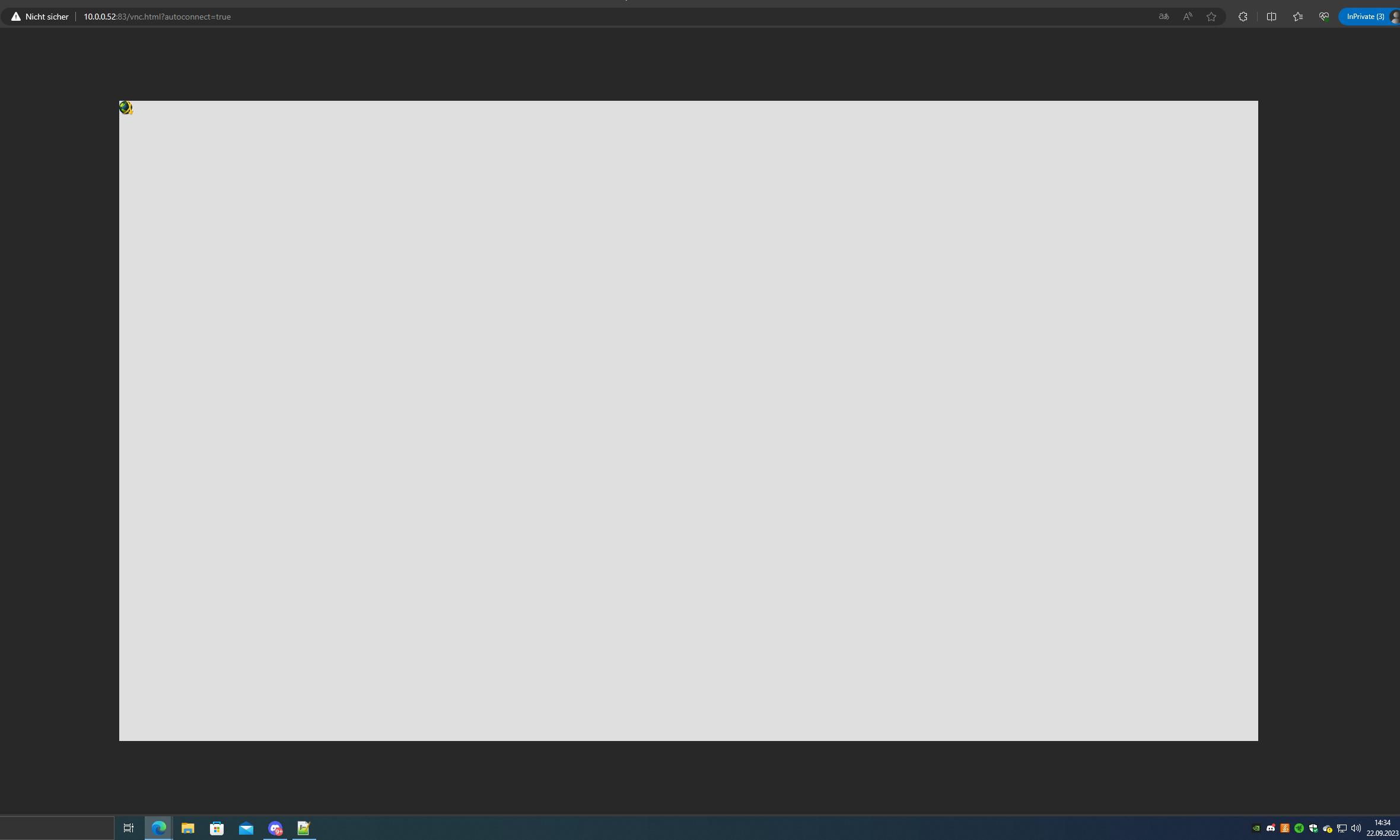

Ive a litte issue that pops up from time to time, nothing horrendous tho.
Is there a way to avoid this from happening? i do have the initial window set to 1080p and i assume thats causing it because i cant recall having seen that on the default.
Have you tried to press ESC or RETURN when this screen pops up?
Would it be a viable solution for you to set the scaling mode in the VNC menu to server scaling? With this you can let the initial resolution at default and the screen will be always be resized accordingly to the window size from your browser.
(click on the arrow on the left hand side, click on the gear icon, scaling, set to server scaling)
However it should not have any mayor downsides to setting it to 1920x1080
What do you do to solve this issue usually?

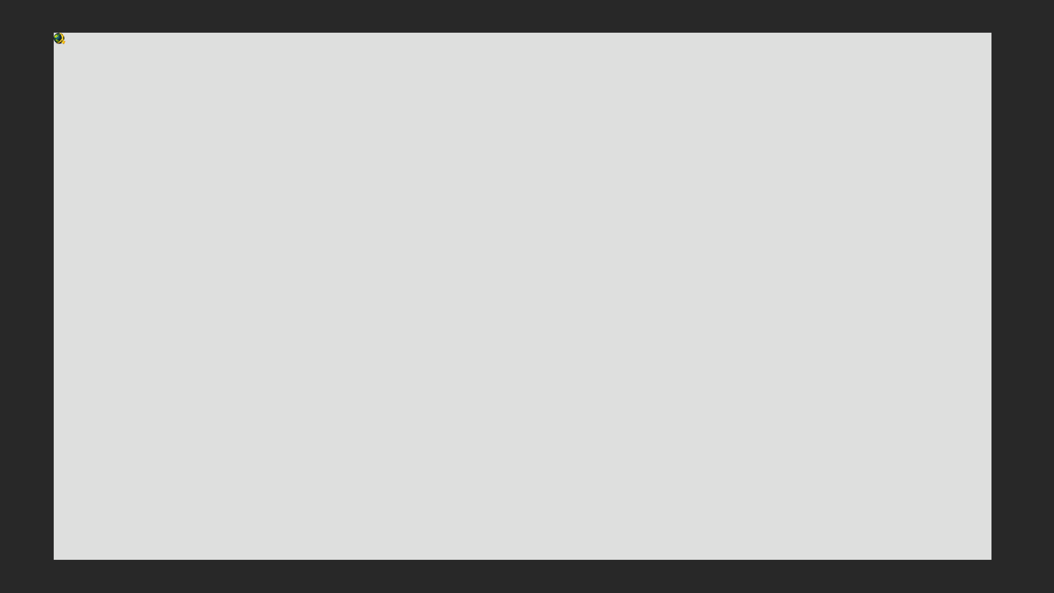

I just open the left tab for scaling and change it to server scaling and that fixes it.
And then I I just resize the browser window to something smaller again, set it back to scaling none.
9 out of 10 times "it just works", just occasionally it does this weird behaviour.
This is really strange, that shouldn't happen at all... Have you yet tried to restart the container and see if this also fixes the issue? If yes, disable the stop from the container if you have CA Backup set up <- this shouldn't harm anything for the jDownloader2 container.
My assumption is that something messes up when it starts but it's really hard to debug, because well jDownlaoder2 :D
Yes it does. Used to do that before i figured out that changing the scaling mode fixes it.
I dont have CA Backup set up to do anything automatically and usually JDL is not running at all until i want to start downloading a bunch of stuff, once in a blue moon.
Edit:
I did check the logs and it i found a difference between the time it appeared and when i just works

11 hours ago, ich777 said:
Which line are you talking about? I can only find 4 lines with the resolution check and they all seem fine.
Yeah, thats when it started, did the weird thing and ive changed the scaling to serverside and back. the weird 1920x1102 must be from when i "fixed" it.
May I ask why you are posting the json log? Do you use another platform than Unraid? If so you can also dump the full log from the container with:
Cause thats the log file of unraid, was already easier to grab from /system/docker/containers/blahblub^^
Are you sure that you simply can't press ENTER or ESC on that screen?
im pretty certain i did test that at one point and nothing happend but ill try again the next time it happens. I did try to "make it happen" again but i couldnt get it to yet.
Edit:
Actually, it doesnt. 1920x1102 seems to be the default resolution when ive set it to 1080p.
I just deleted the log, started it, stopped it and that odd resolution appears in the logs.
Server scaling gives me 2505x1348. mhmm
Ive set it to 1920x720 and it sets it to 1922x792 and its supposedly to be "1920x768" bit funky.
Now ive recreated the container a couple of times and this time, it shows
Request toFront(window is active): jd.gui.swing.jdgui.JDownloaderMainFrame[MAINFRAME,0,0,1920x1080,invalid,layout=java.awt.BorderLayout,title=JDownloader 2,resizable,maximized,defaultCloseOperation=DO_NOTHING_ON_CLOSE,rootPane=javax.swing.JRootPane[,0,0,1920x1080,invalid,layout=javax.swing.JRootPane$RootLayout,alignmentX=0.0,alignmentY=0.0,border=javax.swing.plaf.synth.SynthBorder@49b5adc8,flags=16777673,maximumSize=,minimumSize=,preferredSize=],rootPaneCheckingEnabled=true]
Request toFrontFocused(timer,toFront): jd.gui.swing.jdgui.JDownloaderMainFrame[MAINFRAME,0,0,1920x1080,invalid,hidden,layout=java.awt.BorderLayout,title=JDownloader 2,resizable,maximized,defaultCloseOperation=DO_NOTHING_ON_CLOSE,rootPane=javax.swing.JRootPane[,0,0,1920x1080,invalid,layout=javax.swing.JRootPane$RootLayout,alignmentX=0.0,alignmentY=0.0,border=javax.swing.plaf.synth.SynthBorder@49b5adc8,flags=16777673,maximumSize=,minimumSize=,preferredSize=],rootPaneCheckingEnabled=true]
very bizarr why it was so stuck on the 1920x1102 for 2 recreates.
Edit #2:
@ich777
I got it to do the thing again!
file3.log
and heres the json log from Unraid
file3-json.txt
Ive also grabbed a video of it.
I used the esc button, the esc button from the little menu, smashed enter in the middle of the screen but then, i left clicked on the icon
