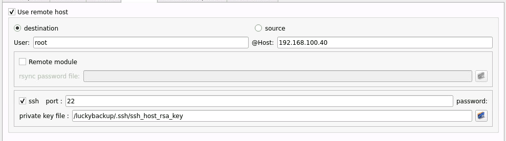

I have luckybackup setup following this guide: https://unraid.net/blog/unraid-server-backups-with-luckybackup
The RSA on the backupserver side should be here: /root/.ssh/
I configured Luckybackup and everything is working fine. Since my backupserver is not always on, after a restart, Luckybackup was asking for a password, for the tasks that used to work with the id_rsa without problems. What could the restart of the server have caused the id_rsa not to work anymore?
That is not correct, it should be always be in /luckybackup/.ssh/ not in /root/.ssh, the tutorial that I linked for you in the other thread is valid both for root and non root usage:
You always have to put/use the keys in /lockybackup/.ssh
SOLVED: run the luckybackup docker with privileged on

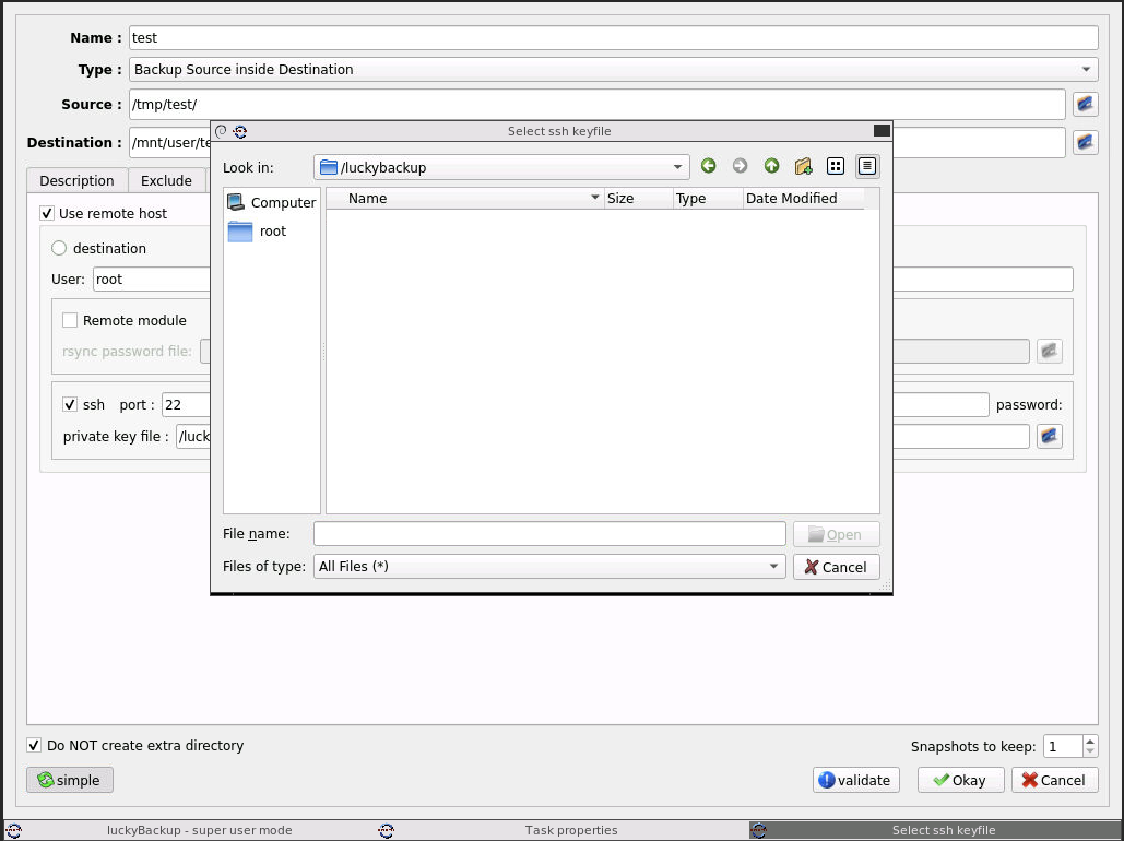

Hi, thanks for the thread and information. How come I do not have that .ssh folder inside of my luckybackup folder?
Edited by TallMan206
Picture added
Because it's a hidden folder you won't see it.
Did you follow the tutorial that I've linked, it's described how to get the keys there, you usually do this from the terminal.
Is it now solved?
Is it now solved?
Yes, got everything to work. Thank you so much for the help.

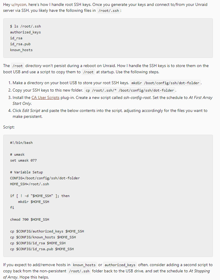

I'm sorry. After a restart of both servers, LuckyBackup asks again for the openSSH password.
Main server: 192.168.100.30: there I putted the rsa inside of luckybackup.
Backupserver is the 192.168.100.40 where I copied the rsa key to from my Main server.
I think is has to do that the authorized keys are being overwritten at reboot.
added reboot line
To what path is the Data Directory set in the Docker template:
Please note that if it's set to /mnt/cache/... then you have to make sure that the Mover is set to take no action for the appdata share in the Share settings, otherwise the container will search for the data on the cache when the Mover already transfered it to the Array.
You have two options:
  1. Set the Mover to take no action for the appdata share in the Share settings and that the Primary storage is set to Cache and no secondary storage is set <- I would recommend doing that for the appdata share anyways because this directory is usually where all your data for your containers
  2. Change the path in the template to /mnt/user/... <- with that the container will find the data regardless where it is stored
Please choose only one of the methods listed above

My appdata is on a separate pool, ssd-pool, where all appdata is stored. Nothing is moving from there to the array/cache. It's an RAID-Z1 pool of three 1TB SSD's. The folder inside of the luckybackup where the rsa is in, is still there (Mainserver)
The problem is the backupserver. The autorized keys seems to dissapear after restart
I'm following this tutorial now to see if the key finally persist
Added tutorial
@ich777 the tutorial to keep the authorized_keys after reboot, works! I've rebooted the server and now the mainserver can connect to the backupserver without issues. Luckybackup works right away!
Just follow the link, it is still working:
Sorry but this is a completely stupid workaround and not necessary!
This solves an issue which simply isn't there if you set it up correctly.
The container works as long as you follow the tutorial that I've linked not the blog post.
Please note that the tutorial I've linked is working as is for me and for many others.
In my case for instance my backup server is always offline as long as I trigger the backup manually.
Sorry to say that but there must be some other weird configuration issue on your side.

Hi ich777, I'm sorry, I followed your guide and maybe I did something wrong or I just don't understand well what you are doing, but I could not get it to work.
Escpecially the part where you make a testfile local is where I am missing the point. As I wrote, the root/.ssh folder on my target server, seems to be emptied every start, and therefore the source server is not allowed to connect to the target server.
Please remove the script that you just installed and we can further troubleshoot...

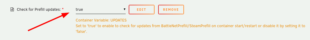

Hello @ich777
my LanCache-Prefill Docker Container does not connect to Steam anymore:
[12:54:37 PM] Already disconnected from Steam
SteamPrefill.Models.Exceptions.SteamConnectionException: Timeout connecting to Steam...  Try again in a few moments
  at void SteamPrefill.Handlers.Steam.Steam3Session.ConnectToSteam()

The Version in this Docker is 2.5 but the official version ist newer (2.7.). Can this be a reason for connecting problems?
Best regards,
Chris
Please enable this option in the Docker template:
This will check for Updates on each start from the container. After enabling this look at the log and see if it actually pulled the update.
You mean on the host so to speak Unraid itself correct? On what Unraid version are you?
Hi, I've removed that script. I am on Unraid 7 beta2. But the problem already existed on 6.12.13.
Anyway, it seems to keep working now, even after some reboots (to try) my issue has been resolved.
Thanks for the help
