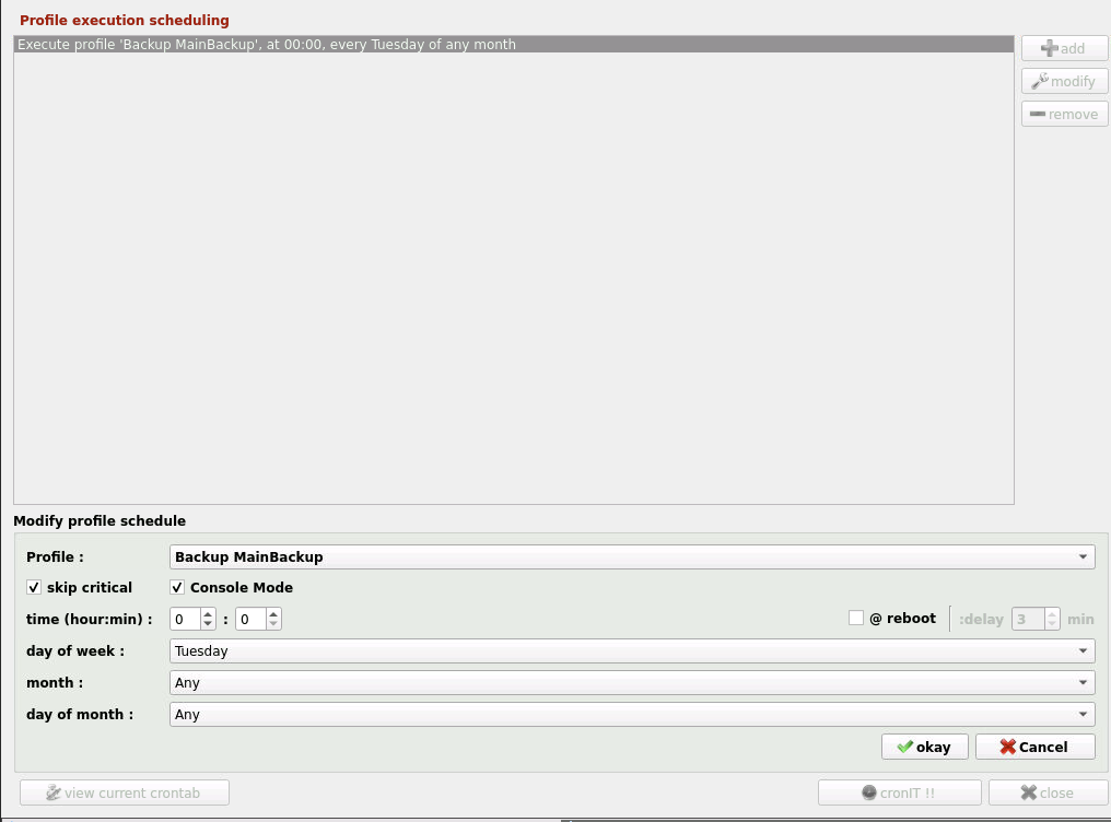

11 minutes ago, TallMan206 said:
The jobs work perfectly manually, and the I tested a lot with the cron to see if they start, but it does not. The time seems to be good inside the docker.
This has nothing to do with the time in general in the container.
Can you please post a screenshot how you've set up the cron job?
Did you also read that in the description from the container:

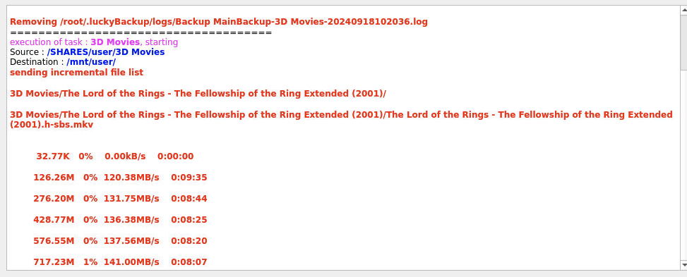

Yes, console mode is on. The script should have ran last night, but the log shows the last run was the 12th of september (manual run). Today I tested the cron with the day on Wednesday, and setting a time for 5 minutes later then the current time. Waiting for the script to start, but nothing happens.
Privileged mode removed!
Here a manual run:

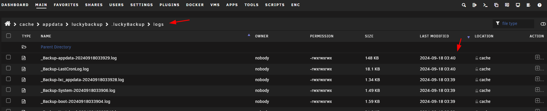

which logs are you looking for ?
the GUI wont update until you restart the container, the logs located in appdata are also not updated ?

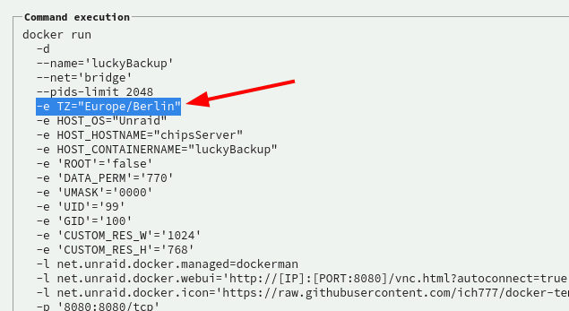

25 minutes ago, Mattaton said:
Also, make sure to set the TZ env variable in your unRAID template.
Please look at your docker run command, on Unraid it is not necessary to add the TZ variable because that is added automatically.
I didn't have the TZ variable in my template but it gets added automatically, that because Unraid adds this variable no matter what (the variable is actually pulled from the timezone that you've set in Settings -> Time in Unraid) :
I think I already pointed that out IIRC.
Gotcha. You're right. I end up seeing it twice in the docker run.

38 minutes ago, Mattaton said:
So, how my setup probably differs from yours is that back the first time I was setting it up, I ended up adding a .profile file in the LB config folder which just contains this:
After thinking again about this, this too shouldn't be necessary since the TZ variable that Unraid passes through is globally available in the container.
Just issue 'env' in the container console and you should see that this variable is there without modifying anything.

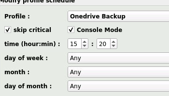

I was too early. It does not work yet. The cron does not run at the set time. I tried with a single folder backup, but it does not run. It is on console mode.
When I type DATE in the docker terminal: Wed 18 Sep 2024 03:14:09 PM CEST
When I setup the cron:
Could it be that I should enter 03:20? Or is that automatically AM then?
Edited by TallMan206
15:20 is 3:20PM
However as often pointed out, it is possible that even if the container displays the right time that the cron job doesn't run at that time, please try to set it to a fixed time and maybe wait for a few hours and see if you got a offset of a few hours and if the job does run.
Maybe try to set it to 16:00 and check back if it did indeed run tomorrow.
As said, I couldn't reproduce this behavior on my server yet.

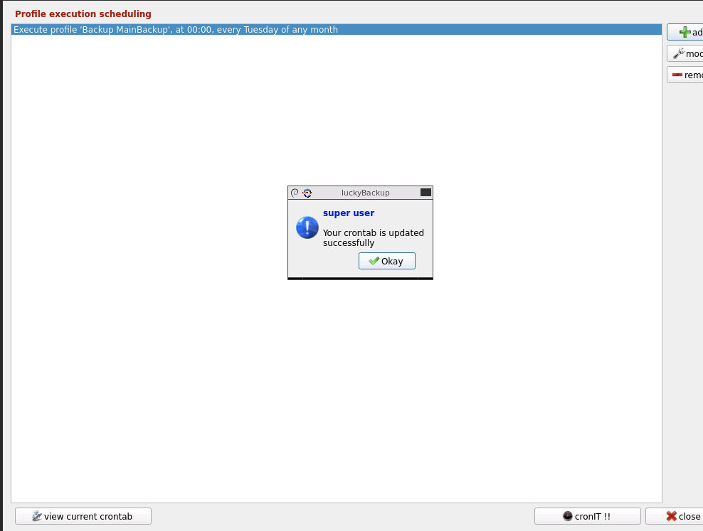

The logs says it's working, I can see the files on my backupserver, and everything is working fine. Thanks for all the help.
The issue: My backupserver starts up on Tuesdays at 23:50. The LB cron is suppose to run at 00:00. This is already Wednesday ofcourse, not Tuesday. I had it on Tuesday. Stupid, stupid, stupid. My mistake. I'm happy it has been resolved.
