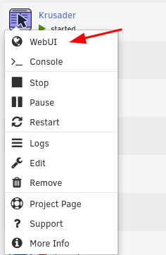

Hi, As a newbie I hope I am doing this in the correct place.
I just pulled and installed ich777/krusader When I choose the icon (It does not have a name), adjacent to the name Krusader I can open a console and expected a split screen view. Instead I opened a page which flashed white and settled as a blank black page with #.
I have always installed dockers from the CA page and this is my first attempt not using that page.
I must have done something wrong or not done something. Would you please assist this old fella?
You have to chose WebUI not Console.
There is no webUI option.
I've confused myself. lol

I removed the docker and reinstalled it. This is the result and still no WebUI.
What am I doing wrong?
I think in order to have the webui button, you have to use the template in unRAID (dockerman), enable advanbced view and then fill in the webui field.
Looks like you are doing everything via terminal instead.
Is there some reason you're doing that instead of using CA?
What happens if you try to go here:
http://192.168.1.249:8080/vnc.html?resize=remote&host=192.168.1.249&port=8080&autoconnect=1

I brings up No VNC connect
I am embarrassed once again! I was using the wrong search box!
Thank you for your help offers
Please remove the Container and reinstall it from the CA App.
Seems like there is something wrong...
Sorry but what are you doing? Go into the CA App and download the application from there (Apps tab within Unraid).
