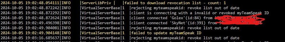

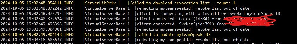

Hi, i am using your Teamspeak Docker.
Today i did update the Container and now i get these errors:
-Revoke list out of date
-failed to update my teamspeak idScreenshot2024-10-06013447.thumb.jpg.831df759f1b775561df6b873ddce2d2f.jpgScreenshot2024-10-06013224.jpg.d6e3e20dd6755f83abd9e7ec2cfa411b.jpg
Cant find anything to solve the problem. Any ideas ? 😀
What do you mean you updated the container?
I pushed no updates, the last update was pushed 19 days ago.
From what I see you are using TS5 correct?
Are you sure that this is not an issue with your TeamSpeak ID?
I don't even have any of that message in my log.
Thank you for your quick answer 😀
I klicked on Update (now its up to date). Its Teamspeak 3.
After that, all clients get the error message on connect.
Today everything is fine. No errors on connect, and the log file is also clean.
Edited by oldAzzBstrd
So everything is working now?
Maybe Teamspeak themselves had issues and that‘s why you‘ve saw the message.
