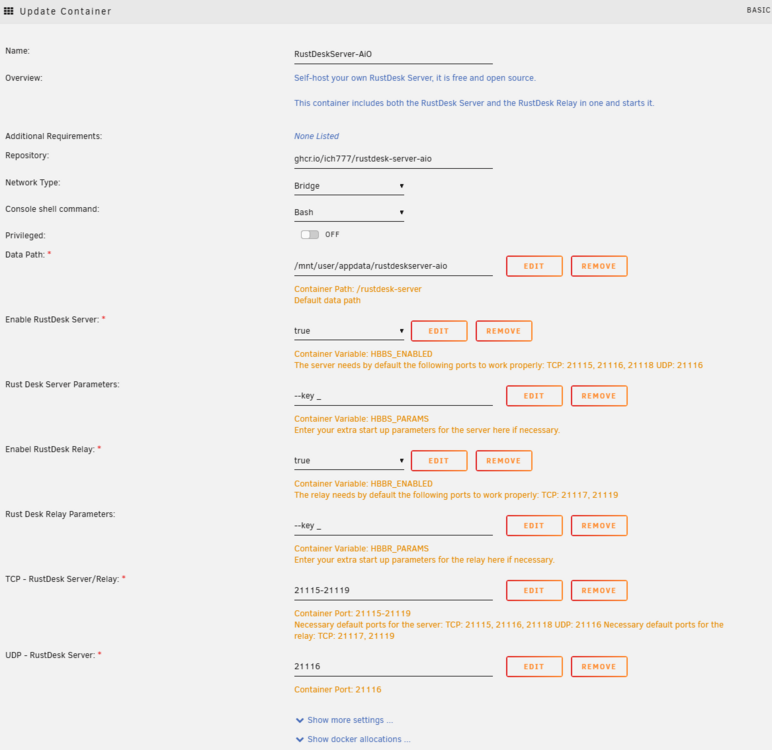

Hi, Im not sure if this has been asked before and I've missed it.
Im currently having an issue with rustdeskserver-aio, everytime the container restarts its generating a new key. Is there any way to hardcover the key or to prevent this from happening in the future?
Thanks for any assitance!!

On 12/6/2025 at 3:33 PM, ich777 said:
I checked and I've got it set correctly in the /mnt/user/appdata/rustdeskserver-aio folder. It still refreshes the key file ever time its reloaded.
What do you mean with reloaded?
If the path exists and the container is able to write to this path the key won't be refreshed, if it's refreshed there is something not correctly configured in terms of the path I assume.
I really can't tell since it's working on my server and I assume for many others here too.
The key is physically written into the main directory from the container and displayed on every start from the container in the logs, if the keyfile exists it won't be overwritten.
Sorry, by reloaded I mean when he conainer starts it replaces the key file with a new one and I end up needing to re-enter the new key in my devices. I'll try deleting it and re-installing it later today and see if that fixes my issue but I dont use a cache on my system and its writing to the default appdata folder directory that all my other containers write to without issue.

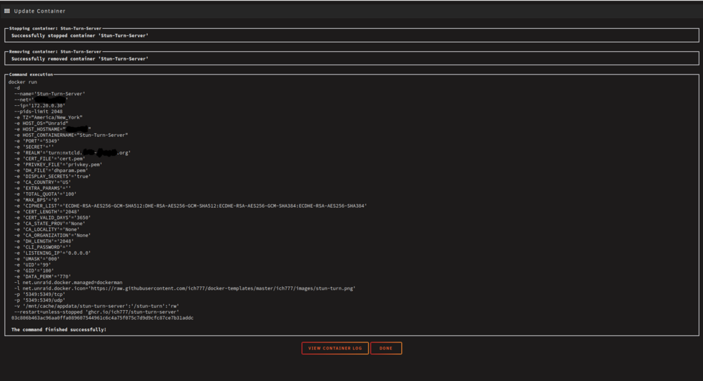

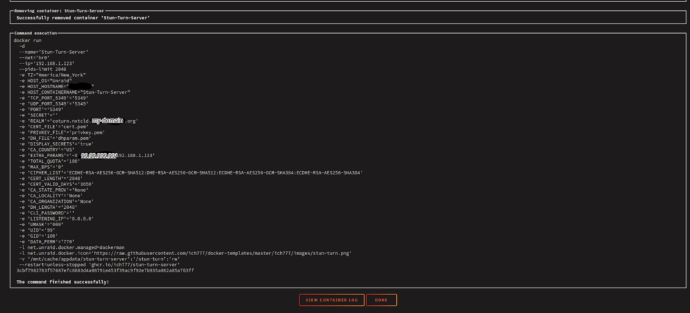

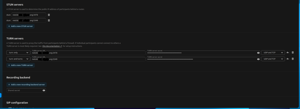

Hello, I was wondering if I could get some help setting up the Stun-Turn-Server for use with Nextcloud Talk.
My Nextcloud instance is the Nextcloud-AIO-mastercontainer from SpaceInvaderOne, proxied with Nginx Proxy Manager and through a CloudFlare ZeroTrust tunnel. The AIO Stun/Turn server won't work through cloudflare, so I tried setting up the Stun-Turn-Server container to use instead. My docker run looks like this. The network type is my custom docker network with a fixed container IP (I also tried host mode, but it didn't work because the nextcloud AIO Talk container wouldn't start anymore.) For realm, I tried it as "turn:nxtcld.my-domain", as well as "nxtcld.my-domain.org".stun server edited.png
My NextCloud AIO admin interface looks as follows. I've tried turn: only, turns: only, and turn: and turns: . The secret matches what's in my logs and the appdata folder.
When I run the webrtc Trickle ICE test for all IceTransport values, I don't get any relay results. When I test manually by calling two users on nextcloud talk outside of my home network, the Talk logs show "ICE failed for component 1 in stream 1..." and the calls just do a reconnecting loop. My network setup is an AT&T Fiber Gateway (BGW320-500) in DHCP mode with my Unraid machine connected to it directly. Ports 3478 and 5349 are open to my Unraid machine tcp/udp. I've checked with a port checker on another PC on the LAN and the port is open. I don't have the stun-turn-server proxied at all. Am I missing something simple? I shouldn't need to change anything in CloudFlare regarding my nextcloud instance, should I? Since the Turn server is running separately externally? Thank you
Please do keep in mind that a STUN-TURN Server needs to have direct access to the internet without any NAT and usually you don't have it on your network because otherwise it will give you the wrong IP addresses.
Jup, STUN-TURN needs to be directly reachable from the Internet.
It has to run in host or in br0/eth0 mode otherwise it won't work properly.

I'm new to home networking so I'm sorry if I don't understand something. I can't bypass my NAT currently because my ISP is quite restrictive. However, I see under extra parameters where you linked the coturn github wiki that there is this section:
"-X, --external-ip <public-ip>[/private-ip] TURN Server public/private address mapping, if the server is behind NAT. In that situation, if a -X is used in form "-X <ip>" then that ip will be reported as relay IP address of all allocations. This scenario works only in a simple case when one single relay address is to be used, and no CHANGE_REQUEST STUN functionality is required. That single relay address must be mapped by NAT to the 'external' IP. The "external-ip" value, if not empty, is returned in XOR-RELAYED-ADDRESS field. For that 'external' IP, NAT must forward ports directly (relayed port 12345 must be always mapped to the same 'external' port 12345). In more complex case when more than one IP address is involved, that option must be used several times, each entry must have form "-X <public-ip/private-ip>", to map all involved addresses. CHANGE_REQUEST NAT discovery STUN functionality will work correctly, if the addresses are mapped properly, even when the TURN server itself is behind A NAT. By default, this value is empty, and no address mapping is used."
So I got my public IP via the unraid console with curl ipinfo.io/ip (Let's call it 99.99.999.99) and my container IP is 192.168.1.123. I then put "-X 99.99.999.99/192.168.1.123" in extra param. However, the logs on startup say "No external IP set". I also tried "-X 99.99.999.99" and it also says no external IP set. Shouldn't this work at least until my ISP updates my public IP? Sorry if I don't understand fully.
Here's my updated docker run if it helps:
I also tried making a DNS record on my cloudflare domain of coturn.my-domain. org and set it to my public ipv4 address with DNS only (no proxy). then I updated the realm field to this domain and updated my container. With this new domain. the test button on nextcloud administration panel returns a green checkmark. The trickle ICE test still won't return my public IP or any relayProtocols, and my nextcloud calls still reconnect endlessly. I think this is close to working
Edited by Friarsgate_Customs
Then hosting a STUN/TURN Server is most of the times impossible.
But we are not talking about a Webserver, STUN/TURN, is it's own application and won't make use of that.
Again, a STUN/TURN Server should be deployed on a VPS outside your network, TBH most of the times it's enough to use any of the public available STUN/TURN servers since they only provide the IP where to connect.
You can take a look here.
A STUN/TURN Server is not a simple Webserver.
