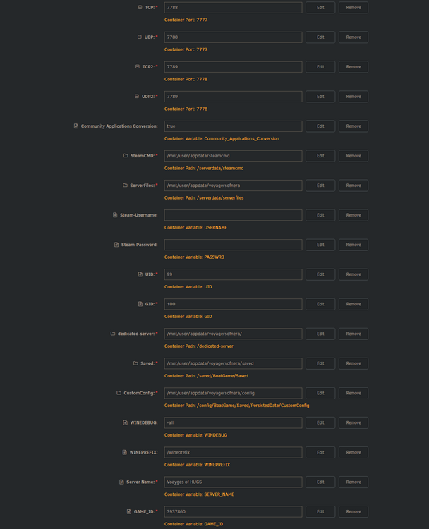

Hi Ich777
I understand you are not taking requests for new images, but I was hoping you could advise on a template I made using your existing VRising template. I have modified the template and such and it shows as installed, but it iss:
1) possibly installing to root as I see the folders there
2) is creating the folders in appdata but not installing the files in the folders. Was there anything specifically you had to do to get things working with steam?
Im attaching my template, again, I just need advice on how difficult it was to get the install to work, and if there's anything i can do to make this happen. I think I have everything correct. But I dont' know why it installs to root
This is the docker: https://github.com/Faucon-Noir/Docker_of_Nera
Edited by korefuji
Sorry, but first of all this is the wrong support thread, secondly I can't help with that since I don't know how this dedicated server is working/starting in general and I don't know/own the game.
Thanks for replying.
So as an alternative I used your other code here:
https://github.com/ich777/docker-steamcmd-server
My commands are below. It installs, files are in the correct directory it says start server, but it shuts down no errors
docker run --name Voyager -d \
-p 7788:7777 -p 7789:7778/udp \
--env 'GAME_ID=3937860' \
--env 'GAME_NAME=Voyage of Nera' \
--env 'GAME_PORT=7789' \
--env 'UID=99' \
--env 'GID=100' \
--volume /mnt/user/appdata/steamcmd:/serverdata/steamcmd \
--volume /mnt/user/appdata/voyager:/serverdata/serverfiles \
ich777/steamcmd:latest
Edited by korefuji

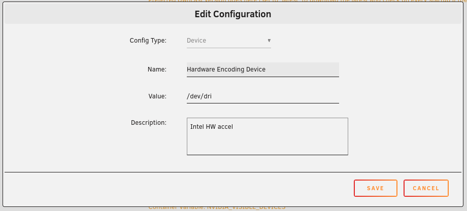

Ahoy! Cheers for all the hard work on the docker images.
Been doing some searching and I can't really find anything definitive. I'm using the Owncast image, and I can't for the life of me get the Intel VA-API thing working.
My device is running on an Intel N100, I'm on Unraid 7.1.1, I've installed the Intel GPU TOP (2025.10.29) plugin, and recursively changed permissions on /dev/dri to 777, and added /dev/dri as a device to both Jellyfin and Owncast. Encoding works just fine in Jellyfin, but doesn't in Owncast. I even tried running Owncast as privileged with no success.
time="2026-01-02T21:56:18+01:00" level=error msg="[AVHWDeviceContext @ 0x55e6328114c0] libva: /usr/lib/x86_64-linux-gnu/dri/iHD_drv_video.so init failed"
time="2026-01-02T21:56:18+01:00" level=error msg="[AVHWDeviceContext @ 0x55e6328114c0] Failed to initialise VAAPI connection: -1 (unknown libva error)."
time="2026-01-02T21:56:18+01:00" level=error msg="Failed to set value '/dev/dri/renderD128' for option 'vaapi_device': Input/output error"
time="2026-01-02T21:56:18+01:00" level=error msg="transcoding error. look at data/logs/transcoder.log to help debug. your copy of ffmpeg may not support your selected codec of h264_vaapi https://owncast.online/docs/codecs/"
Is this possibly a problem with Owncast?
Edited by Dojan
